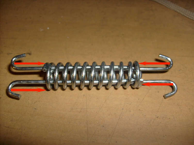

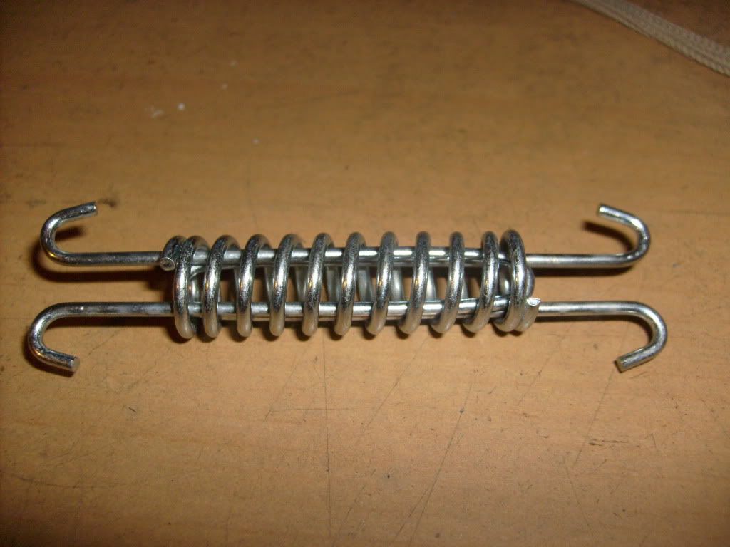

Well I ordered some escort exhaust springs on eBay, 99p each - they arrived this morning but either I've ordered the wrong things, or there are more than one type of them out there? I can't see how these will fit, the two 'hooks' each end aren't attached to the spring, they're simply inside it and slide in and out.
they look correct, push those hooks till they are against the spring, you'll have two loops then.
Obey_R
:D ... do I feel silly now
