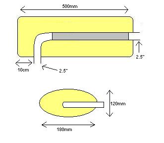

I thought the design of a Duplex or transverse silencer would be like you said early, a "Y" pipe within the silencer box which to me sounds quite simple, please correct me if im wrong
Is this design not easier than the one you have above, the entrance pipe doesnt have to be in the centre, just offset enough to give a little extra length of the box, let me know what you think:

Oh ok, I was thinking you had to have the inlet in the centre!
Yes that would be better if you could get the inlet over to the side, just makes things a bit less complex. The thing is you'll still need a baffle plate in there to support the pipe just after the 90deg bend, otherwise you may get cracks around the inlet.

Oh right that makes sense, I have emailed a few companies to see if they can make me something to that design, dimensions I'm looking at are approx 180x120 (oval) x 500, this should give me enough silencing capacity and still fit in the space I have, will need to fix up some heat plate thou as things may get a little hot under there, will slice a few airing holes to let air in and heat out down the length of the system.
wardy18
Ok emailed loads of companies now and getting rejection, have tried some more.
This is the latest demensions, you dont fancy the challenge do you Cameron, would be doing me a massive favour <_< ?
