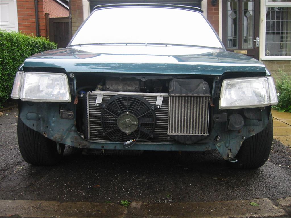

hello could some kind sole tell me were the horn in the engine bay is on a peugeot 205 is please as i cant find it lol?
Henry Yorke
under the passenger side headlight
djinuk
thank you whats the easyiest wway to get to it as my 205 has a mi-16 engine and not much room thanx?
Obey_R
Just pop the headlight out and it should be accessible, I changed mine for a Ring alternative and its only a 20 min job.
djinuk
ok cool how does the headlight come out?
Obey_R
Two spring toggles, push the top of the spring back and pull foward! One connects to the indicator the other is onto a small black plastic box.

no point honking it it dont work lol thats why i want to no were it is so i can fix it

Decided to take my GTI out for a run today and found my horn had given up when i went to use it (not that it was ever that good anyway).
Should make it nice and easy for me to replace it tomorrow now i know i only have to remove the headlight to get to it :) I was worried it was going to have to be a full bumper off job at first.

You've probably already checked but I think the horn is on a separate fuse with the cigarette lighter and rear window heater on some.
They're really easy to replace, don't try and take the bumper off, its far more hassle than its worth!!!
