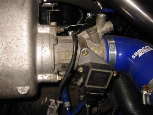

This is my TPS

Mines a 57mm machined out throttle body with larger butterfly... running KMS tps and management

The standard throttle body? So do you all use mappable management then? As have heard you have to make a bracket to make it work the other way or something for the xu10 management?
You dont just swap the polarity of the feed / earth and it reverses the scale

As in swap the wires around? Not electronically minded at all!
Yep the earth and feed, not the potentiometer read back to the ecu

Again excuse the noob question, but which wires are which? :P

Off the top of my head I wouldnt be able to answer that without looking at a 406 diagram, BUT I seem to remember its the two outer wires on the plug, I know emerald uses a 5v feed to it, I know we had to switch the pos & neg to get the resistance to rise and fall the right way around, just looked at a 6' Diagram and its pins 1 & 3, pin 2 (Red) being the sensing wire from or to the ECU, Feed being pin 1 (White) and earth pin 3 (Green/Yellow) But that is on a 6'

Cool thanks! :o
