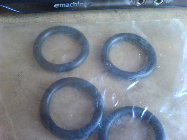

Is this them?

Not sure that they're the right ones but a decent o ring might possibly do it. The proper ones are availae through pug via forign pug dealers.
I just siliconed my original seals back in the last time I had the cam cover off, it's worked fine so far.
DrSarty
Dimensions may be right, but they are more like Polo mints than inner tubes, i.e. the side walls are square not rounded.

Mine measured (and they've no doubt compressed a tad) 7mm height x 39.5 OD x 27 ID.
I'd say your looked up dims are close enough. Pics later.
Jrod
Mine came with a genuine headset so can't help you getting them but....
8.5mm tall
39mm OD
27mm ID

They are also square edged just like in the picture Jrod posted.

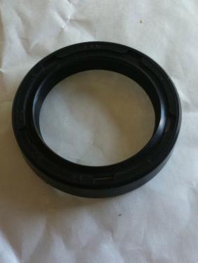

The seals have arrived. They do look slightly different to the ones in the picture earlier in the thread.
These have a ridge on them. Not too sure if this will be a problem as the dimensions are correct and when its face down there is a seal.
What do you guys think?
are they solid? as that's what the original ones are IIRC.
smokey
Well not fully but they look the be re-enforced ones as i can see a spring and metal in there.
But like i say when pushed against something they seem to grip a seal well. Whether this will be enough, i dont know?
I've taken some better pictures for you to see.
wrong type of seal, that's for a rotating shaft.

So no joy then? Didn't get to see them as I ordered them over the phone.
Looking at them i thought they might be ok but like you say are for a rotating shaft.
