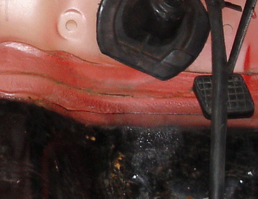

It's really not in bad condition at all, very little rust, a little under the boot and inner wings but only surface. Also a leaky crack where the bulkhead joins the floor but easily sort as agiain its surface rust

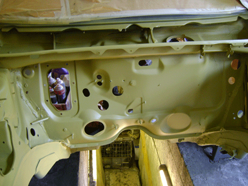

Sorry it's been such a long time in coming but here is an update! Finally got the engine bay ready to paint up, with other things to get done around the house I've been wanting to get to this for a couple of months, one because I love working on the car and two There's loads I can do in terms of rebuilding once its done.
Luckily there wasn't much in the way of corrosion, just surface rust mainly. The only problem area was in the crease where the inner wing meets the bulkhead on the drivers side. Pug obviously use seam sealent to fill the joint but over time it gets brittle and splits. This lets water into the gap and lets it run along the floor pan to bulkhead joint. This has happened on mine and started to show as a split in the seam sealant on the inside lower bulkhead. Shown in the piccy.
We cut back the sealant cleaned her up and treated with anti rust then sealed back up when dry. On the engine bay side there was loads of gunged up sealant just trapping in moisture so we dug back to the original, poured in inhibitor, let it dry for ages the some waxoil to repel moisture then again after a few days a little new seam sealant. Unfortunately no pics of the seam repair!
Then lots of sanding and cleaning.
Then a nice barrier layer to prevent any reaction to old paint etc. I really love the look of a flat clean surface!!
Then on to the primer, again it looks great, almost a shame to paint it black!
And finally the coat of black.
All I have to do now is decide to give it a couple of layers of laquer to match the boywork or leave it flat. I kind of like it flat!

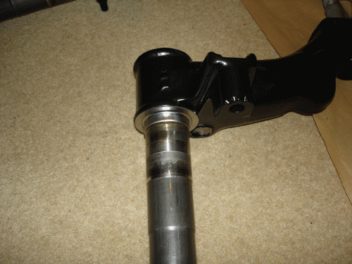

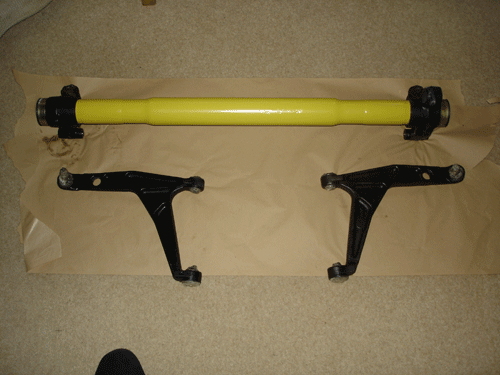

Ok, just wanted to get the images of the sorted suspension parts before they go on the car. Firstly the beam and mounts. I had the beam itself as a refurb off jord294. I then painted it as close to the original yellow I could get in a can from halfords. The mounts were de rusted and plated with a zinc / yellow passivator as original. I also managed to get hold of the correct Zinc/yellow bolts, washers and nyloc nuts, Peugeot can only now supply non plated versions which wouldn't last 5 mins! I did all the bolts for the beam parts but had to buy in quantity so there may be a group buy post for sets of bolts washers and nuts if anyone's interested.
I also had the torsion bars cleaned up and powdercoated along with a load of other bits which I'll post as and when. I just need to put the yellow marks on the bars now!
As for the trailing arms, these were blasted and coated after I had the stub axels and shafts pressed out at my local! The guys down the road then pressed them back in and put new cups on for me to give a good seal.
In total with all the beam parts coated / plated including loads of bits you're yet to see all I've had to pay out is £20 for plating and £30 for blasting and powder coating, oh and a tenner to get all the pressing done! Not bad at all for something that now looks new. Wait until you see all the other bits :lol::blush::D

Those pins look worn in those pic's, Should be a nice shiny surface without bearing marks in them.

i think to do a proper job, a new pair of shafts are needed

I admit the picture does suggest that but on close inspection there is only very slight 'polishing' where the original bearings were, the beam i took apart was in good working order, there's certainly no tangible wear and they're still a very tight fit! Having said that you guys have had way more experience in this and that may constitute significant wear! What would you consider acceptable considering the £150+ to get new ones?
Depends on how long your going to keep it really, Short term then it should be Ok or long term I would replace them and you'll know they won;t be touched again for 10 years
£100 off ebay for a pair if they have any left :mellow:
