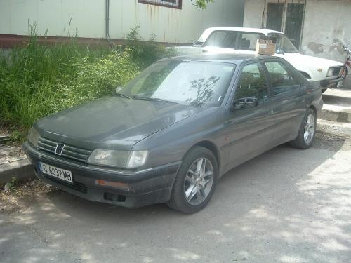

Hi again,
This is my personal project for Peugeot 605 2.0 8v turbo upgrade. I decided to modify the whole car, including engine, suspension, cooling system, ECU, brake system, headlights, etc, etc.
AND the car audio system at last.
AGAIN - please have my apologies for my English, I am doing my best to describe everything very simply to avoid huge mistakes.
So, here everything started.
