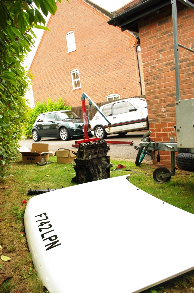

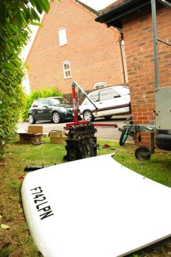

Cracking on with it now.. Engine out in a couple of hours :)

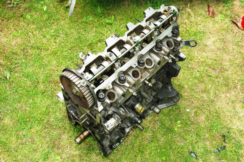

Before the head came off..
This baffled me too..

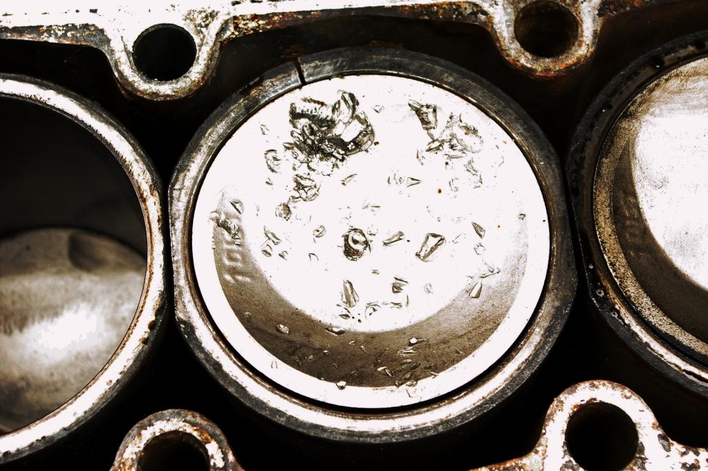

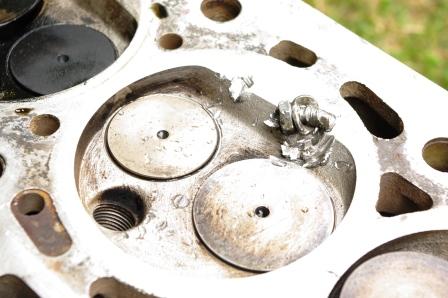

Untill I finally found the C**T.
TU_Later
URGH. So has anyone got a spare piston and liner? :)
I hate cars. And don't ask how it got in there, this was the point that my old man put the head on the block.. f*** knows. Eff my life, more money ;)
Bugger, at least you found the problem though.
