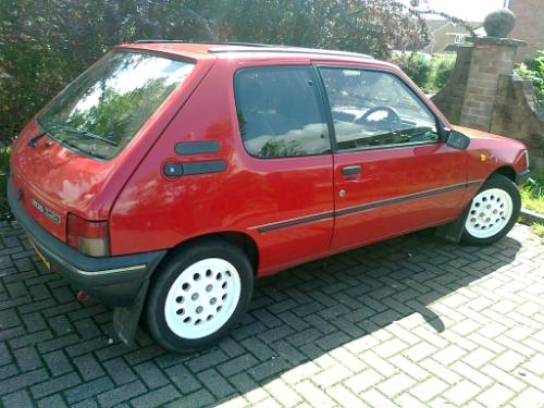

sceptre 0 Posted August 6, 2010 Ok chaps, just a quick question here. I have a 205 1.4i Sceptre which currently has 165/70T13 tyres on it. I really want to get some original 205 alloys on it (pepperpots?) but I am very confused whether they will fit and if they will be legal? According to kwik fit I think the tyres for them are 185/55V15, this means they are wider and shallower right?? I've heard stories of having problems with brakes and wheel arches etc so I just want to check before I buy a set! and wheel sizes are different to tyre sizes yeah? Help? Confusion! Share this post Link to post Share on other sites
richsmells 2 Posted August 6, 2010 (edited) These are pepperpots. They work well and look good on base models. Tyre size is usually 185/60 R14 It's the larger 1.9 Gti wheels (15") that sometimes cause problems with the arches on base model shells. Edited August 6, 2010 by richsmells Share this post Link to post Share on other sites
Anthony 1,003 Posted August 6, 2010 These are pepperpots. They work well and look good on base models. Tyre size is usually 185/60 R14 Indeed - I used to run 1.6 GTi "Pepperpots" on my 205 XS... Share this post Link to post Share on other sites
vinorak 4 1 Cars Posted August 6, 2010 I´m using 165/65 R14 on my xs Share this post Link to post Share on other sites
sceptre 0 Posted January 23, 2011 1.6 pepperpots look like exactly what I'm after! So does the R stand for Rim? So a 14" wheel would end R14? And the figures are made up width/depth right? Share this post Link to post Share on other sites
muddatrucker 125 Posted January 23, 2011 1.6 pepperpots look like exactly what I'm after! So does the R stand for Rim? So a 14" wheel would end R14? And the figures are made up width/depth right? R stands for Radial, which is the way its constructed - pretty much all tyres are radial though as far as I'm aware. Share this post Link to post Share on other sites
Henry Yorke 270 3 Cars Posted January 23, 2011 The other ones that fit are 306 Harrier wheels from a 306 dTurbo. And you want 185/60/14 tyres and not the ones Kwikfit said. The advantage to Harriers is that the centres push out so can be balanced easier. Share this post Link to post Share on other sites
Daviewonder 533 3 Cars Posted January 23, 2011 (edited) 185 60 R14 185 is the width in mm 60 is the profile (60 = 60% of the width) R means Radial type tyre 14 is the diameter in inches Edited January 23, 2011 by Daviewonder Share this post Link to post Share on other sites

sceptre 0 Posted July 9, 2011 finally got round to getting some sorted, looks fab. Thanks again for all the help! Share this post Link to post Share on other sites
