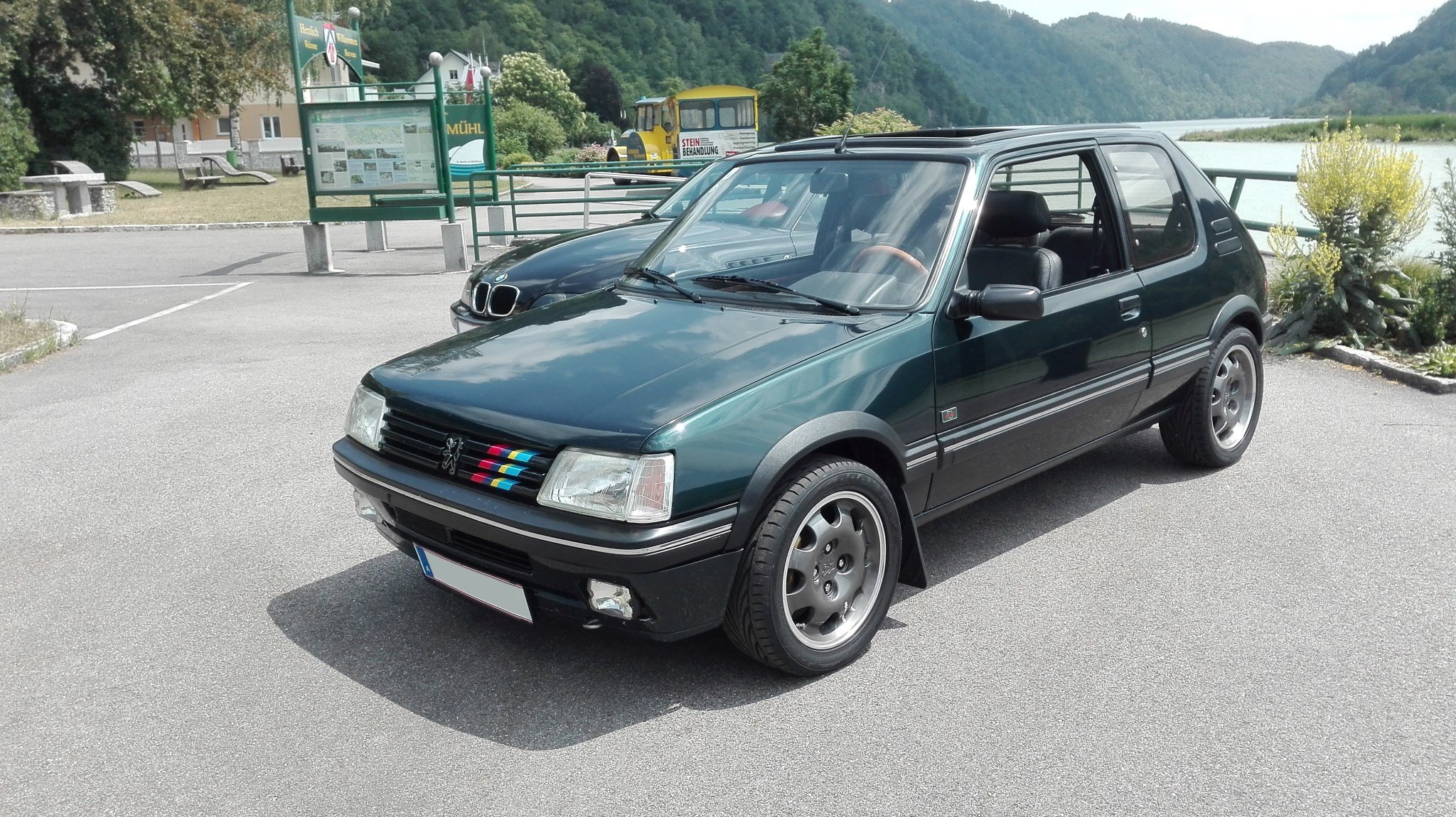

Welcome everybody to the Peugeot 205 1.9 GTI "Goodwood" (No. 1 of 1) :P
finally completed :wub:

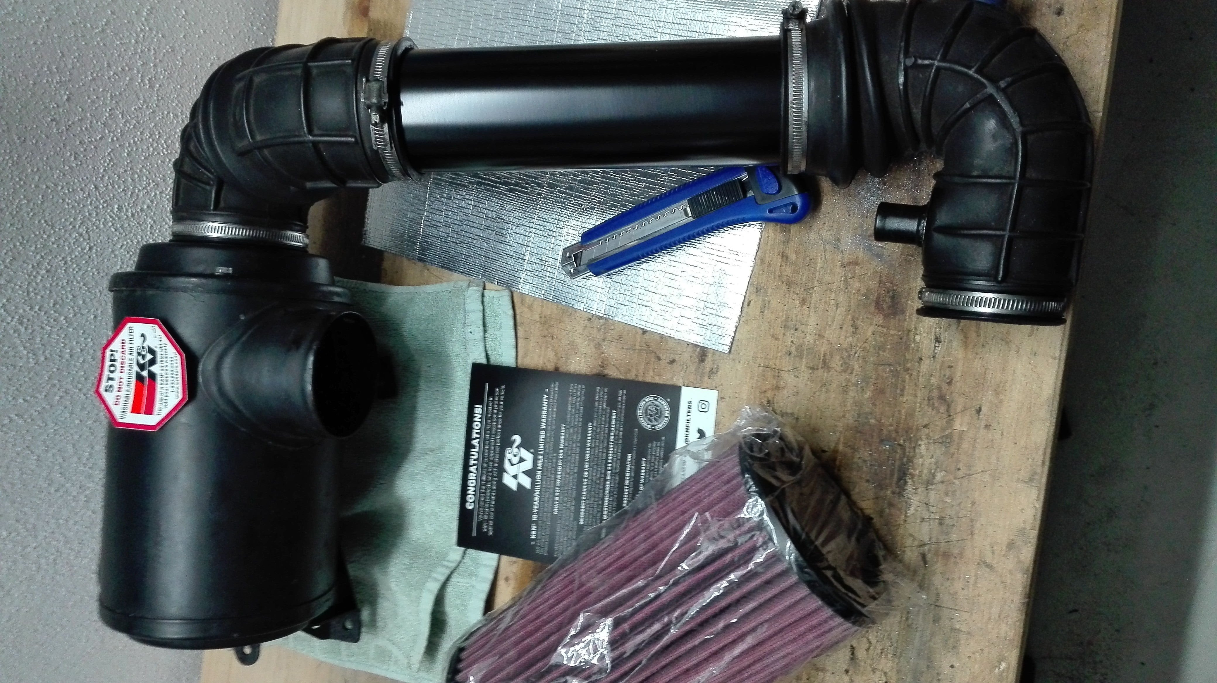

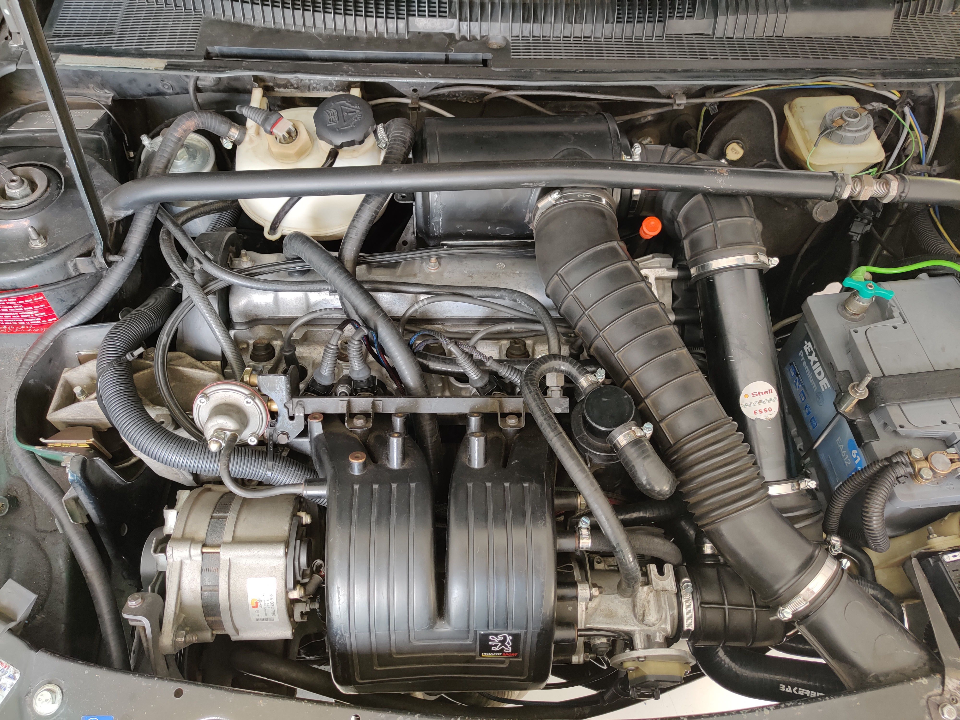

Engine, ECU and exhaust system have acutally received some major updates during the last couple of years:
(I will upload some imagery in a minute)
Along with an engine overhaul, the XU9J1 (102HP) cylinder head was ported and airflowed, and compression ratio increased to around 9.6:1.
A Schrick 268° camshaft, wide throttle body and other little mods were added.
To protect the new hardware, I upgrade the oil cooling/lubrification with a sump baffle, 6 bar oil pressure spring and external Mocal oil cooler (you can spot it in one of the earlier images).
I first ran the engine with an XU9JA (128HP) ignition and increased fuel pressure, which delivered good power, low-down torque and throttle response (with that in mind, I had deliberately chosen to stick with the original, yet modified cylinder head instead of a big valve head).

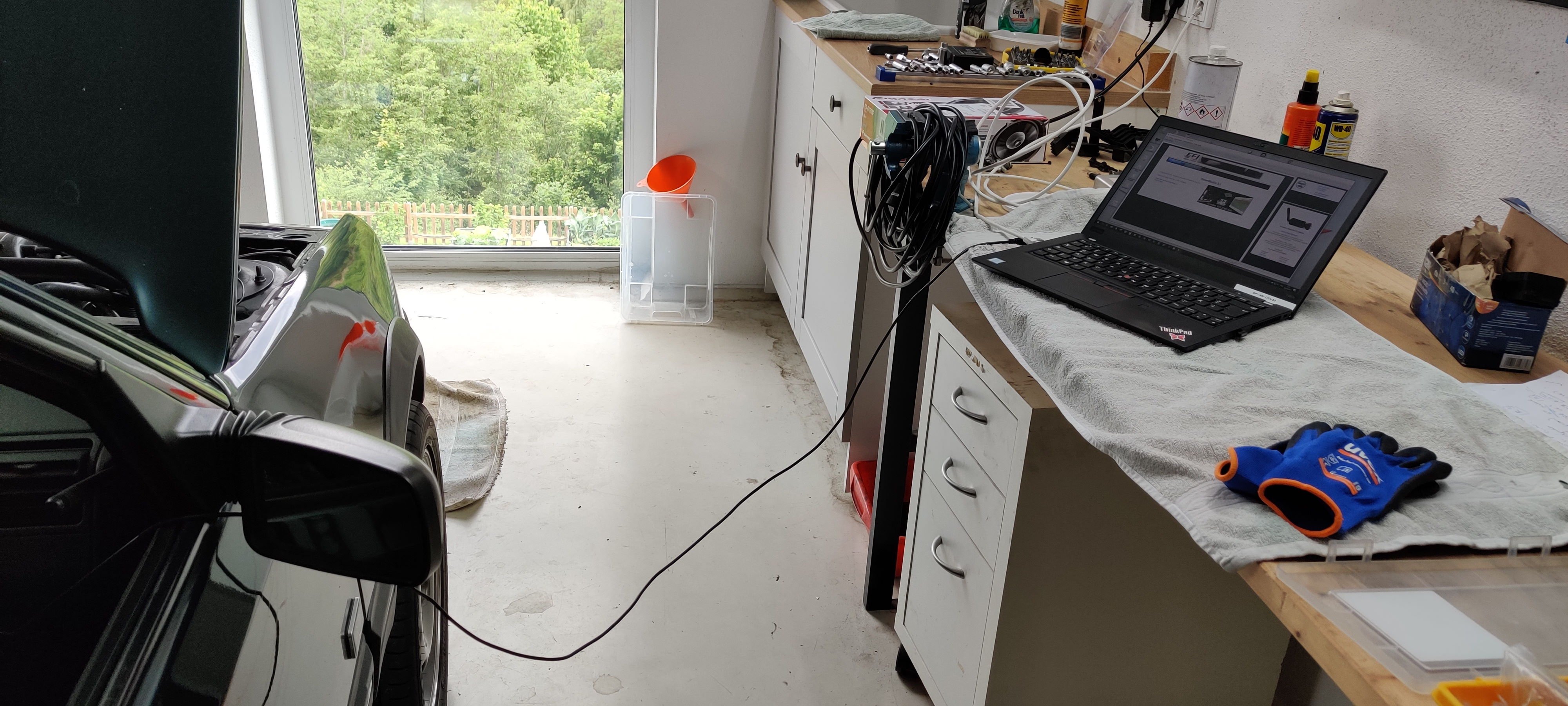

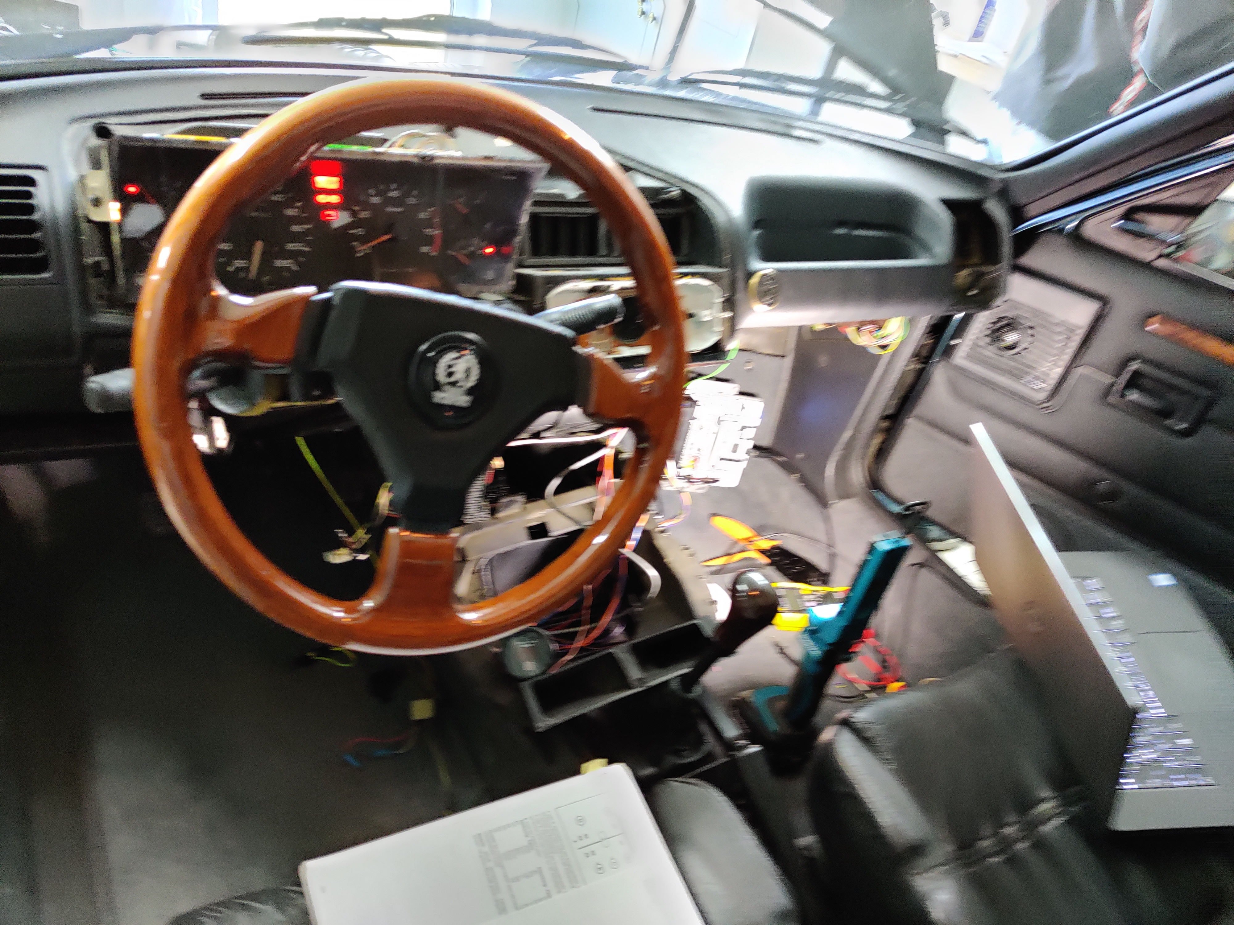

However, in spring this year, I finally went for a freely programmable Megasquirt MS3 ECU. This required an ignition harness from a Peugeot 306, a flywheel from a XU9JA/Z (120HP), a wideband oxygen sensor and quite some additional sensors as well as an almost complete rewiring of the engine bay.
The engine feels really strong now and low-down torque as well as top-end power have again increased substantially.

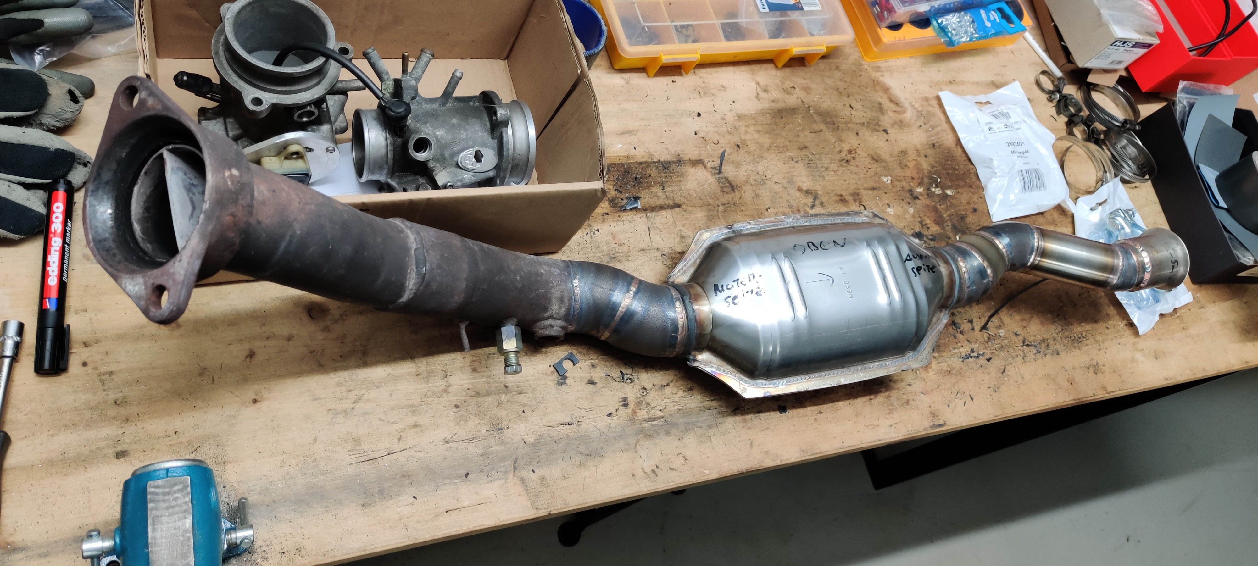

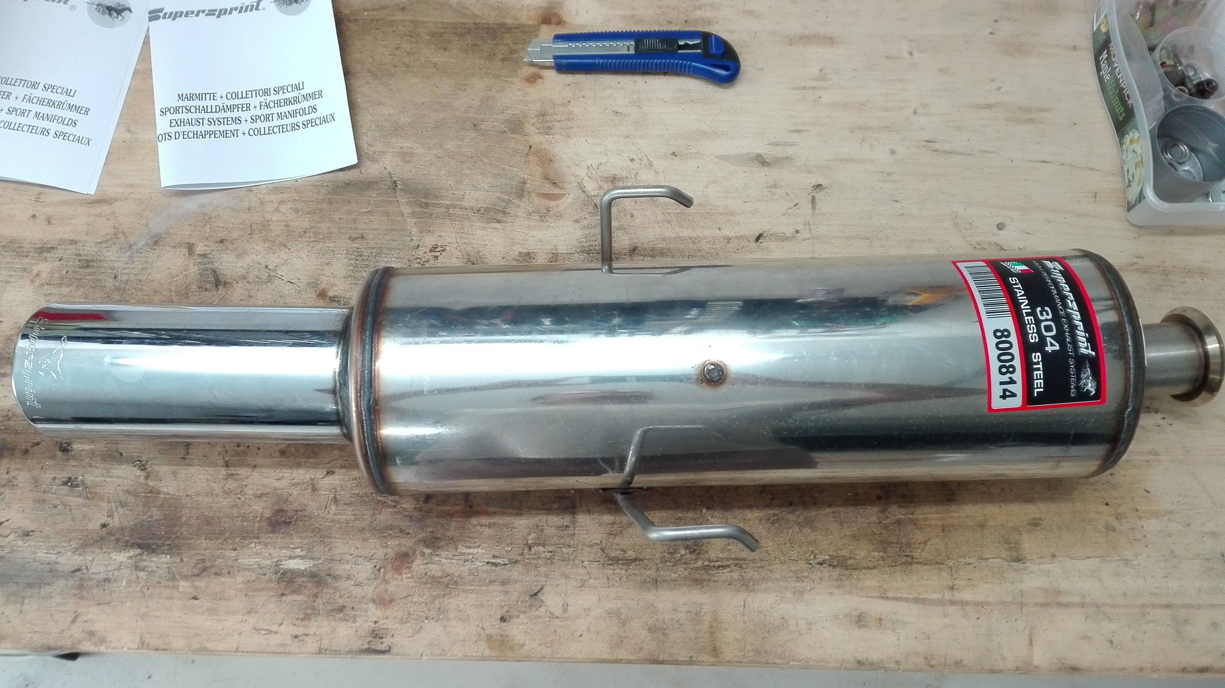

Finishing touches included a Supersprint exhaust system and 20cpsi catalytic converter.
Edited by Kobayashi
added some images

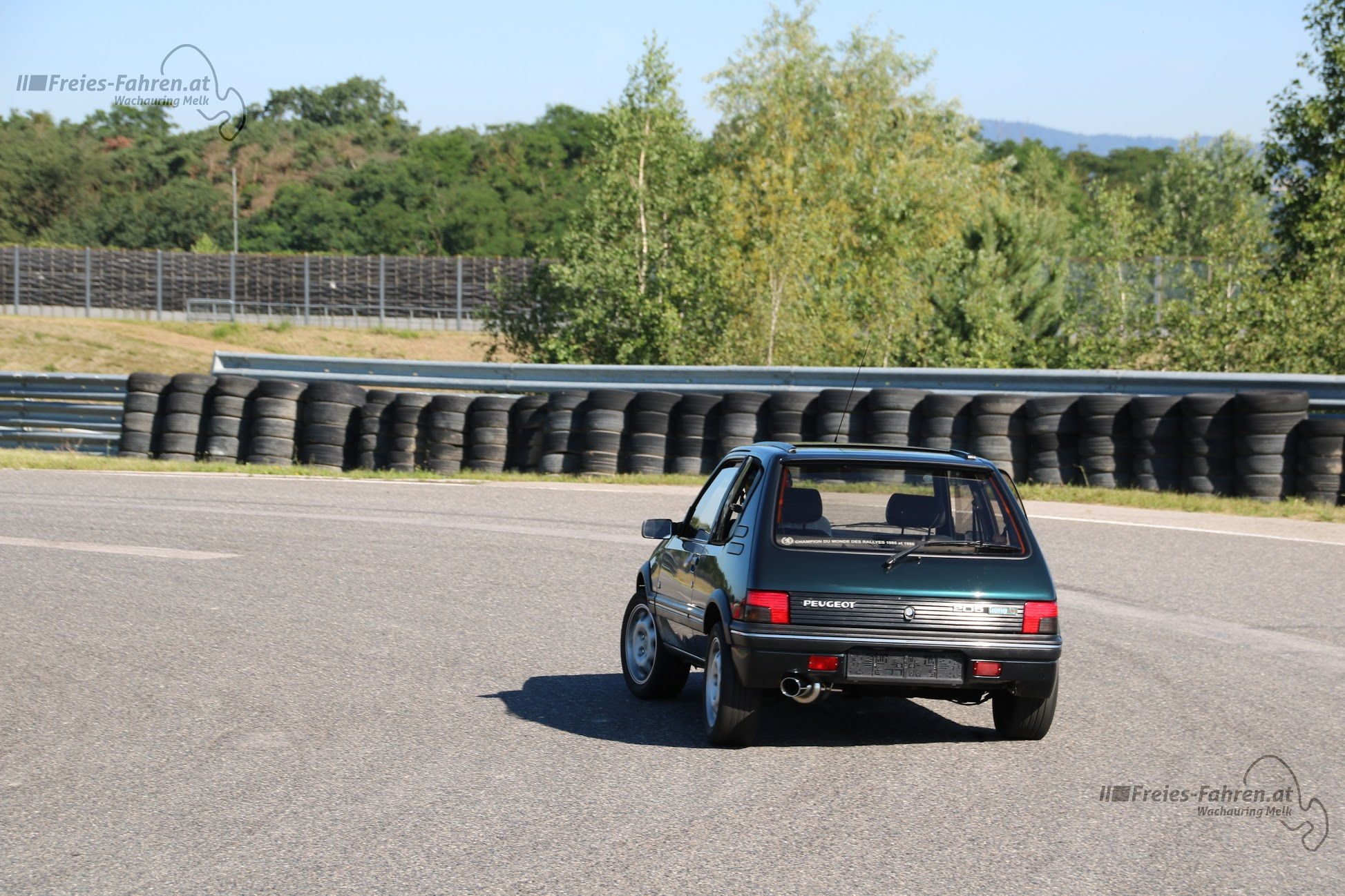

Some action shots of a trackday and another event that I recently participated in.
I am extremely happy with the engine now, but as some of the pictures indicate, the next mods will include supspension (along with brake) upgrades. Body roll is definitely an issue...
Nevertheless, on a narrow circuit, I managed to keep up with that red Toyota (GT-86 with 200 HP) fairly well, and also with some of Cup-Saxos (as long as they used road tyres) ;)

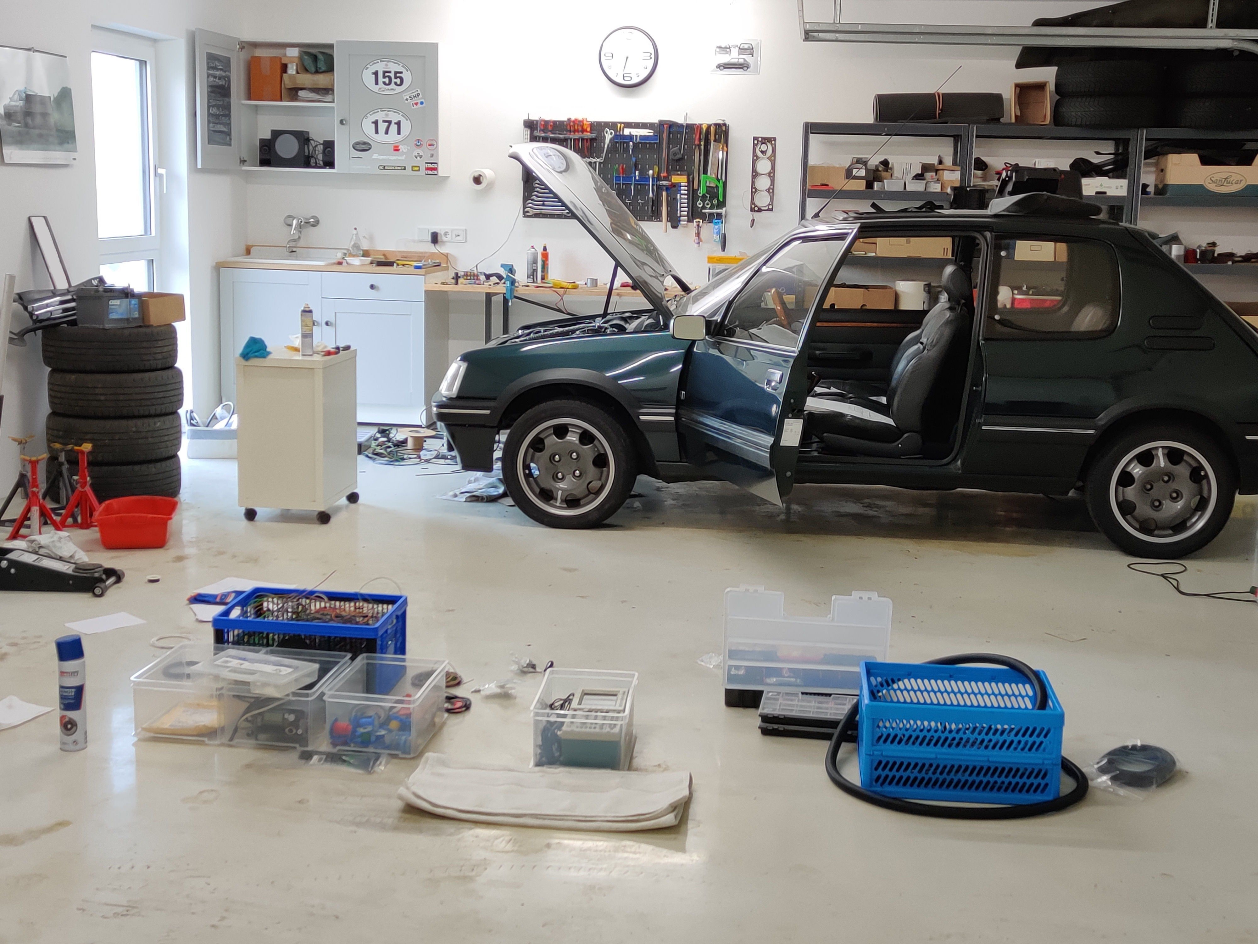

Recently, i reworked and upgraded the suspension. And by suspension, i mean all of it B)
The goal wasn't to just lower the car, but to really match the increased engine performance with better handling, while taking into account what i learned from my first track day in June 2020 :ph34r:
The following parts list also includes a 4 discs brake conversion with larger diameters in front, as well as a rear beam overhaul.
A lot of the parts were sourced from UK's BakerBM and Pug1off (before Brexit struck).
Stuff that was fitted to the car:
- ST 'X' coilovers (by KW)
- 'narrow track' front axle as on 1.9 GTI (my car had the 'wide track' 1.6 GTI setup before)
- 266 mm front brakes with new calipers (as on Peugeot 206)
- new front triangles (SKF)
- new drive shafts (SKF)
- 19 mm front ARB (donated from a 309 GTI 16v)
- 25 mm rear ARB (from Pug1off*)
- 23 mm rear torsion bards (from Pug1off*)
- rear arms with more negative camber (as on Peugeot 306)
- 247 mm rear brakes with new calipers (as on Peugeot 306)
- new rear beam studs and bearings (Meyle / SKF)
- solid rear beam mounts (Baker BM 'Grp. A")
- steel braided brake lines all around (Goodridge)
- new master cylinder (Pagid)
- brake pressure reduction valve (Wilwood)
* Pug1off states that they use a different material, so their diameters are not 1:1 comparable to OEM items
I love the look of (more or less) shiny parts before they are bolted on to the car :wub:
Edited by Kobayashi
