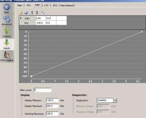

Just had a look at your re-shell pics :lol: obviously no TPS with the GTi6 manifold but I notice the MAP sensor isnt connected up. Doesnt the ecu need some signal from the intake side on load to change from idle to WOT? or am I barking up the wrong tree?.

Just had a look at your re-shell pics ^_^ obviously no TPS with the GTi6 manifold but I notice the MAP sensor isnt connected up. Doesnt the ecu need some signal from the intake side on load to change from idle to WOT? or am I barking up the wrong tree?.
I'd imagine he's using TPS for load. MAP for load on N/A is pretty unusual except for OEMs. Some people will use a 1bar MAP sensor for barometric compensation, but rarely for primary load sensing
I disagree entirely. Where did you hear/read that? MAP sensor is a far better solution for a N/A engine with a plenum type manifold. It will give a far quicker and more accurate reading of engine load than TPS. I only use TPS for throttle body applications. And even then, I put the fuel on TPS and the ignition on MAP if possible. A properly mapped N/A plenum engine doesn't even need a TPS, other than to detect throttle transients.
You usually can't use the GTi6 MAP sensor however, as they work backwards electrically for most aftermarket ECU's.
read what i said. UNUSUAL. I made no mention of any technical benefit either way. It's far more common for TPS to be used with an aftermarket ECU as primary load. And I didn't read or hear it anywhere, I worked for OMEX, and setup dozens of cars like this, including my own clio
Canems ECU can ;) simply tick a box and you can reverse the signal
That doesn't make it right. Anyway, it's probably more of a local thing, as UK has a lot more 4cyl cars, where vacuum is weak on performance cars. Here, we have more turbos, 6cyl and V8's where vacuum signal is strong. I've only been a Haltech dealer since '93 so please be gentle. I also used the word unusual. In latest Haltech's the inputs are fully programmable, so anything is readable. Sorry to get off track.
