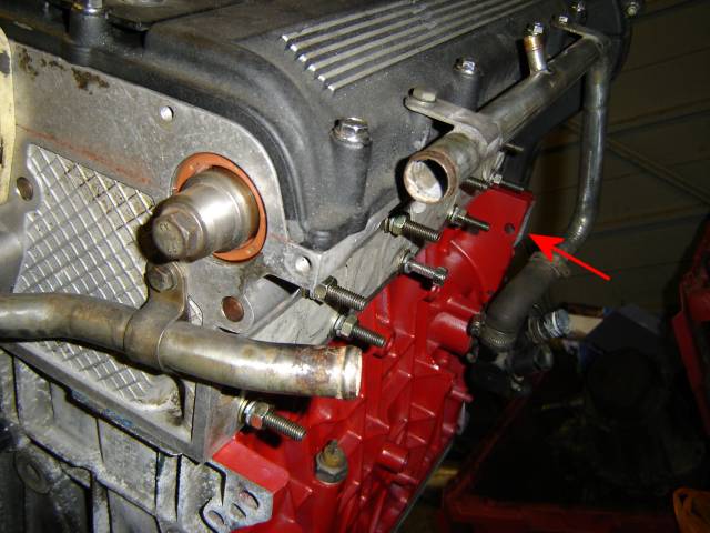

Ryan
The engine number is stamped on a metal tag riveted to the back of the block at the timing belt end - right in the corner where it meets the head:

number2301 so when you sent off your log book did you just write in the new cc?
Because were Ryan (above) shows the tag i cant get to see it and cant see any other tags.
