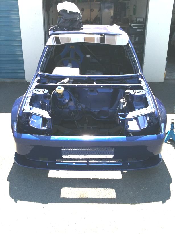

wardy18
So the preperation for spraying begins.
Re-moulding new arches
Shortening the rear arches to fit better
Lightening Doors and Boot Lid
Adding extra bars to roll cage (using the old cage as spares)
Fitting Boot/Bonnet Pins
Repairing gel coat cracks in Fibreglass bonnet and front bumper/valance/splitter
Shortening Battery Tray
Flushing Boot and Rear Qtr Panels
Cutting outer lip from rear inner arches to allow lower ride height and no cutting into my tyres

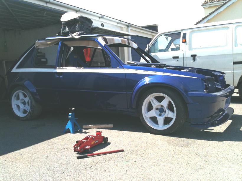

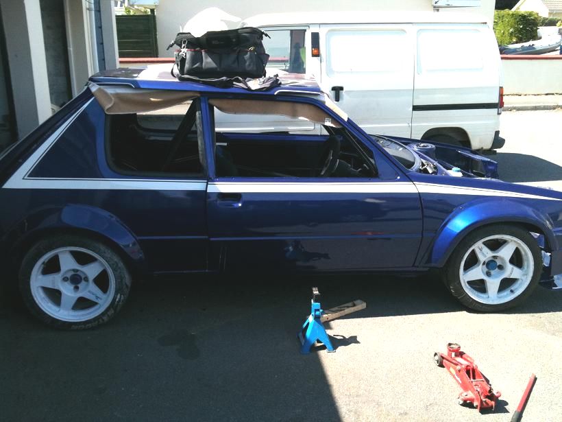

Now came the horrible task of rubbing down filler work and scotching down ready for primer then wet n dry down the primer and doing any last minute adjustments before the colour is applied. Then all the masking up and degreasing. Overall it took 3 people 2 days to get it all done including the tedius task of changing the yellow in my revolution wheels to white. But as everyone know with any paintwork, preperation is key so patience and perserverance is necessary.
wardy18

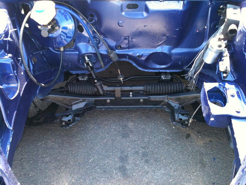

Now all the paintwork is done its bit i enjoy, building all the parts from the old shell into the new one but not before a good clean, re-con and re-paint to make everything nice.
You'll see the Rose Joints boots i have fitted to my wishbones, what an ingenius idea they are!!

Awesome stuff mate.....you've not wasted anytime getting a new shell sorted......looks great....what is the colour?
wardy18
It's Imperial Blue mate, flip tone blue/purple! I'm aiming for the next hillclimb on the 31st May but it's looking more and more outta my reach as the weeks slip by, just so time consuming to clean, re-con and paint everything but I want it done right. After such a big impact everything needs breaking down and checking!

MrG
looking fab, in fact from some angles it looks a little. dare I say it, Chevette HSR or Talbot Sunbeamish.
Not a fan of the stripe, but its a damn fine looking beast. Hope it all goes to plan Wardy.

Update - (Pics to follow)
Rear beam is now converted to discs and fitted with my 21mm Torsion bars and 24mm ARB (already solid mounted from boombang)
I cut the new rear screen and rear qtr Lexan windows last night and tinted them then fitted them in
Front Lexan windows now fitted back in
Checker plate has been fitted where the passenger seat would go which hols my Fuel cell, Fire Extinguisher and new Elec box.
I have just ordered new connections for my fuel hoses and bought new brake line so that will be the next task. Also had to buy a new OMEX rev limiter and have gone for the one with Launch Control, cant wait to try that out!!
