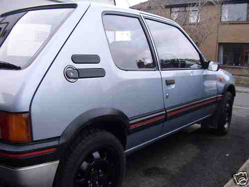

I'm now looking into getting a 1.4 carb engine to upgrade my 1990 1.1 205, understanding that a tu from an xr is heavier and less powerful than the tu from an xs or axgt what are the best mods for either engine?? the TU3S seems harder to find and more expensive so thats why i'm looking into both engines as they're direct replacements giving better performance before being tweaked and modified
