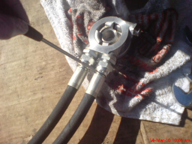

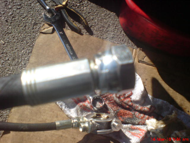

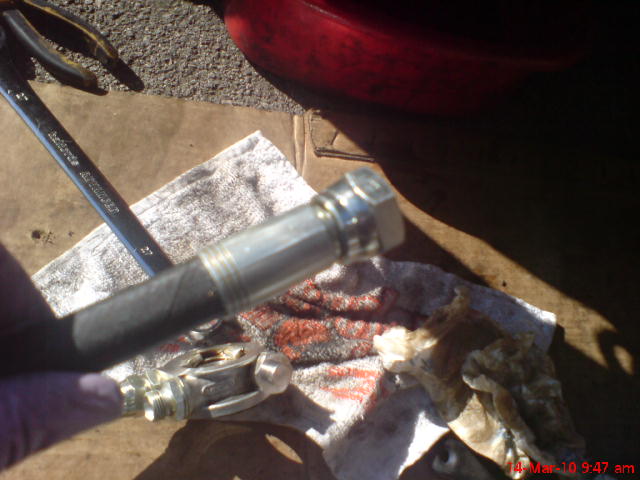

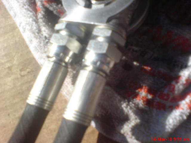

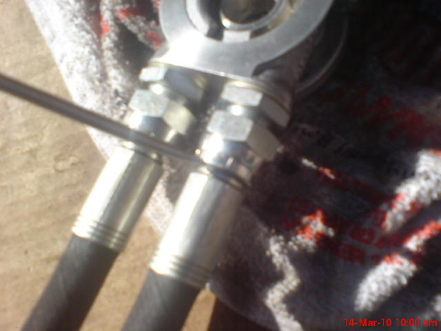

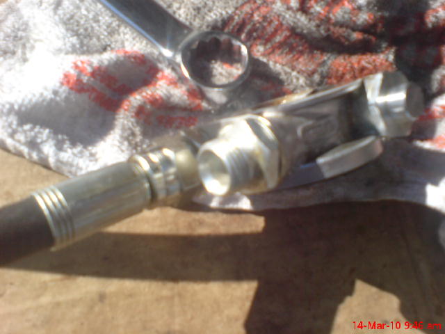

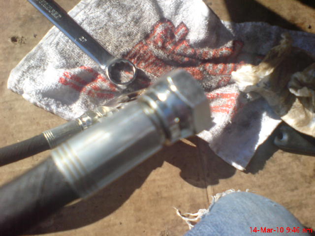

Right, I've uploaded some photos. Hopefully they are of a good enough quality for you to see what I'm on about. I've taken both hoses and sandwich plate/filter off again this morning, refitted everything and tightened as best I can and still it's leaking.
The area of the fitting where the oil is leaking out is shown with the tip of the screw driver in some of the photos. It is where the threaded end of the hose (ie the bit that turns!) clamps down on to the end of the hose inside by screwing on to the sandwich plate. I'm not sure how else to describe it.
So it's not at the actual threads of the hose/plate where it's leaking.
Any suggestions before I take it all off (for the third time) and take the hoses back to Pirtek?
My only thought is maybe I'm tightening them too much? Because on the cooler end of the hoses, I'm just "nipping" them up, to prevent the threads on the cooler snapping off, and they seem to be fine - no leaks at all.

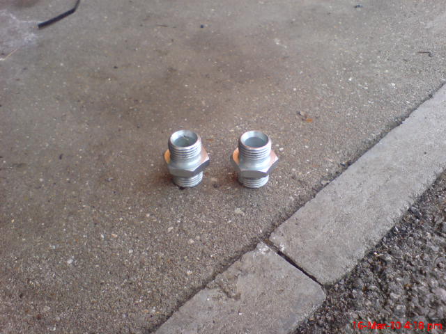

Right, went back to Pirtek yesterday. There are not meant to be any rubber o-rings in these fittings.
They did however say that the problem would be these things (see photo). The ones that came with the mocal plate appeared to have a slightly shallower cone inside than Pirtek's own. So on their advice I bought a couple of their's in order that hopefully they'd definitely fit and make a good seal on the Pirtek hose ends.
Replaced today, but they're STILL leaking, as before. They also put a whole new hose end fitting on one of the hoses when I was there so I can't see it's a fault with a particular fitting (unless they are just generally crap), but haven't heard this before.
Anyone else had problems with these fittings before?
And are there alternative fittings I could use. This is doing my head in. :huh:

I have worked on hydraulic presses for over ten years and used pirtek alot. If they have made a pipe to mate to a fitting and it leaks it is down to them. you should not have had to pay for the right fittings they should have sized them up properly in the first place. We uesed to get problems like this from time to time when you had a new guy on the van.
Try putting ptfe tape around the top of the fitting so it overlaps a little and fold it into the fitting so the cone of the pipe fits onto the tape.
dubble check the fittings they have given you are are the right ones. You can get 2 types of fitting the cone ones and a more square type.
