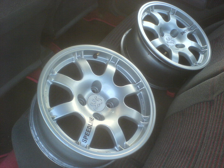

my new wheels B)

Henry Yorke
Proper PTS wheels :D

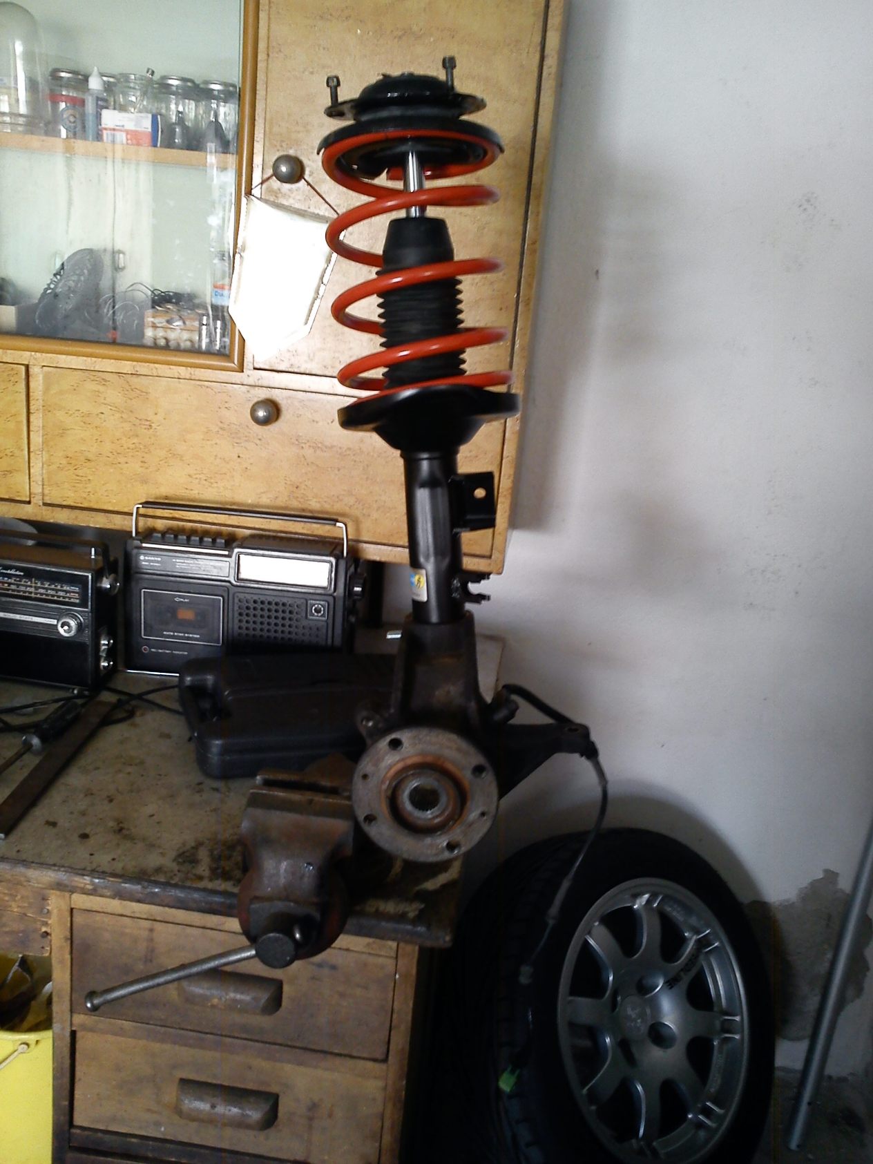

New season and new upgrade :)

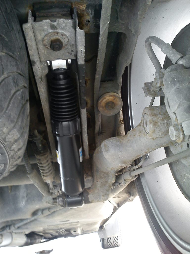

Bilstein B4
-25mm springs

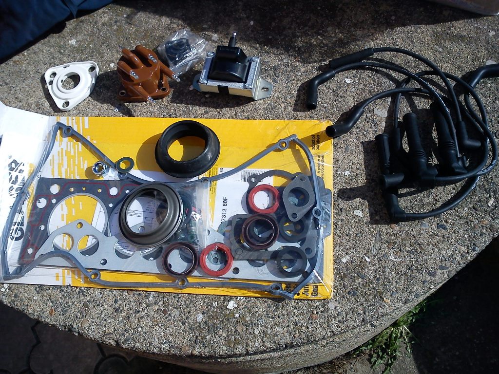

ignition leads, distributor cup, etc.

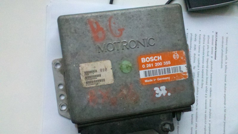

Yesterday i bought last part for my mi16 swap. engine is D6C with knock sensor, GTI16 exhaust , shortened intake, Oil pump and sump from XU10JTE, windage tray , ECU from 4X4 with oxigen sensor. I hope it will run without problem. I can not find 355 or 354 ECU in Czech......

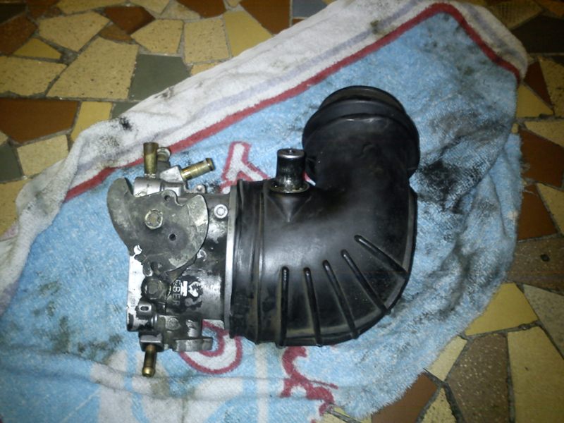

only few bits:
expansion bottle from 206 2.0 HDI - i hope it will fit behind the mighty gti16 exhaust :D
hose from afm to throttle body from gti16

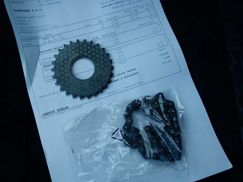

sprocket and chain

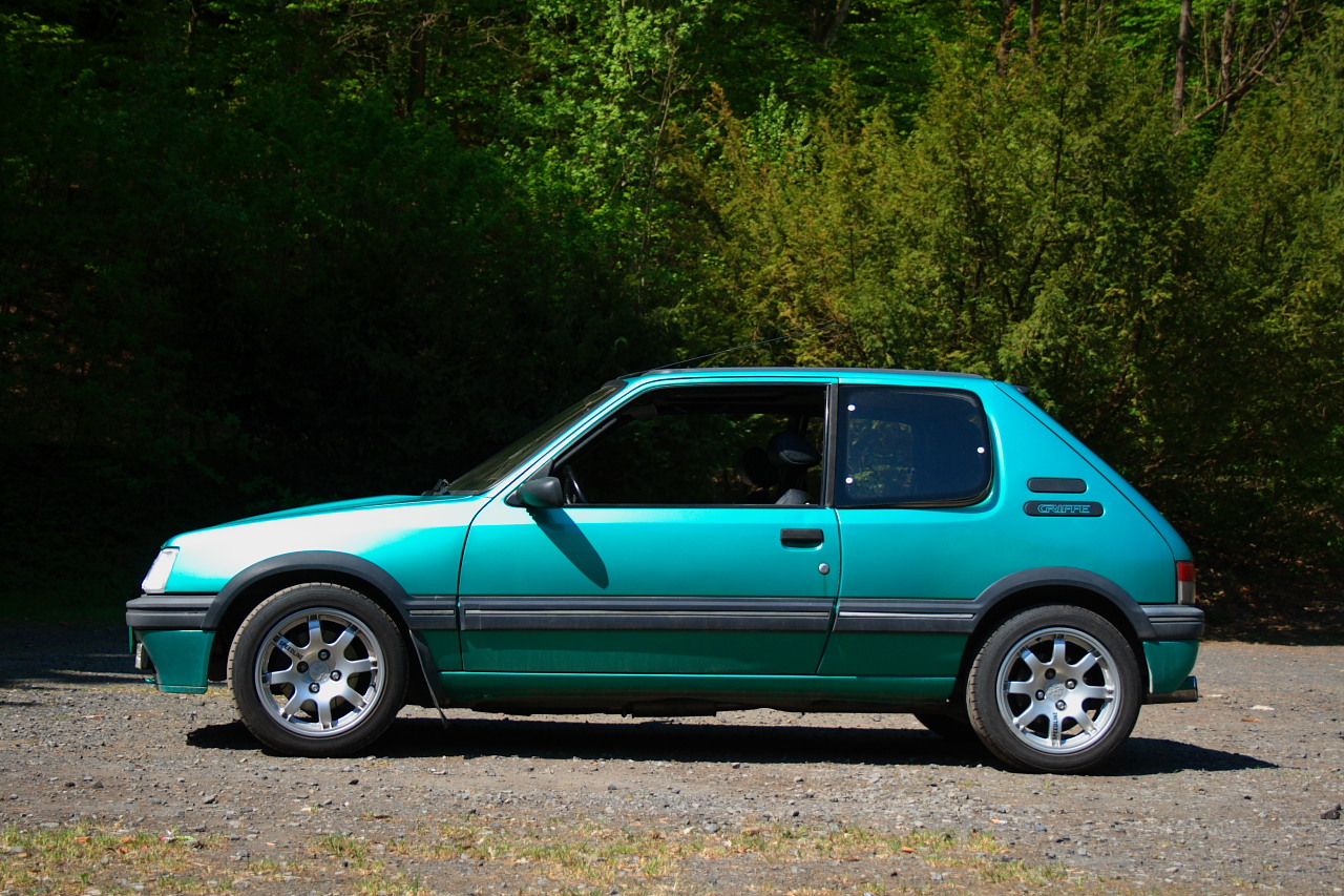

vinorak
I sold ouragans and buy sl434 ;) I must admit that the color was a bit crazy :lol:
Edited by vinorak

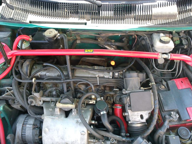

OMP strut brace.

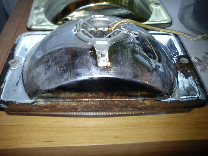

original driving lights SIEM after two years :angry:
