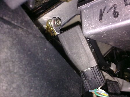

Had a look at the tachymetric relay. It's a Cartier model with a multiplug connector going into its base. The top is attached to some studding along with four black wires also connected to the studding. However, the back wires have been cut - is this a problem?
Which ones ? :rolleyes: can you make us an detail picture of the wiring ?
If the wiring bit is sound , id try with another known good relay as i've had so far various problems with it .. the last time it caught on fire and it would do the whole car if i didn't noticed it :ph34r:
Damir :blush:

The cut wires are on the top-middle of the picture and are fixed to the threaded stud using a round gold colouredspade connectors.
I had discounted the realy being the problem because of the sluggish turn-over, which is why I was thinking more on the power side rather than a relay.
Teh fuel pump remaining on is still a worry.....

On my car there were no wires conected to the stud - it is there just to hold the relay as far as I am aware - so could be other non original electrical items, alarm, stereo etc...???
