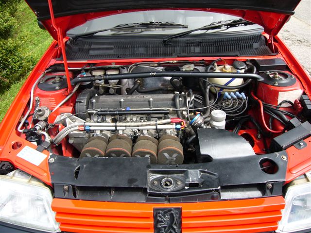

Have seen a few people take the glass off both headlights, at least then it does match. Mine is fed direct cold air straight from the grille and the n/s fog light hole, were I have rallye vents instead of lights.
engine killer

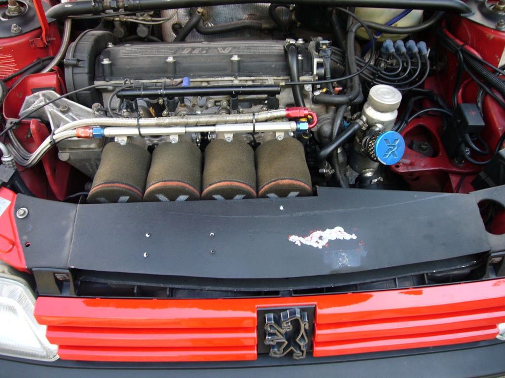

Work on the slam panel or route some ducting from the grill behind the number plate.
You may take a look at what I have done previously as reference. You only have a little room (from right of the the car to the filter) to play with, but I think you can still feed the cold air (when the car is in motion) to the filter side.

Quite neat that ^

impressive that, I'm looking at similar things to feed cold air to my carbs.
engine killer
this should be better i guess
You don't want the air 'rammed' directly to carbs like bodies though, they don't like it!

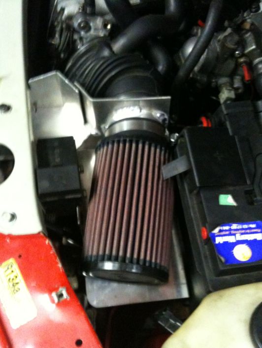

This is what I did for a recent client. I folded/tigged up a new aluminium entry duct which turns air towards the battery. A second piece, tigged to round tube joining air filter to Mi16 rubber, creates a box. The battery is one side of the air box. Works beautifully. The air filter is K&N, offset 10 deg.

I'd say a point here ^^, is not necessarily the channelling of air into the filter/carbs/ITBs, but the shielding of engine bay heat from entering the inlet tract.
That's right Rich. The setup I did was more of a shield than a duct. Once the engine is going, it has no problem drawing in cold air from where ever the source. The main thing is to stop the hot radiator air polluting the inlet air.
