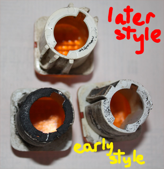

humanz 3 Posted January 8, 2010 Ph 1 side repeaters have a locating plug (however the plug tends to break off over the years). They have a spring type locking mechanism. They do not twist and lock into place. The hole for ph1 side repeaters is circular. Later repeaters twist and lock into place. Their holes are not simply round, as they have additional cutouts for the locking mechanism. I could fire up my camera and take a picture of the two types side by side but it's kinda easy to tell which ones u've got. Just remove the repeater and look at the hole. Sizes can be deceptive. I have a ph2 side repeater next to me which is smaller than the ph1s I recently removed from my ph1 car. Additionally, I think the rubber seals on the ph2 repeaters are thicker than the ph1 repeaters (as seen in the pic with the red gti). Share this post Link to post Share on other sites

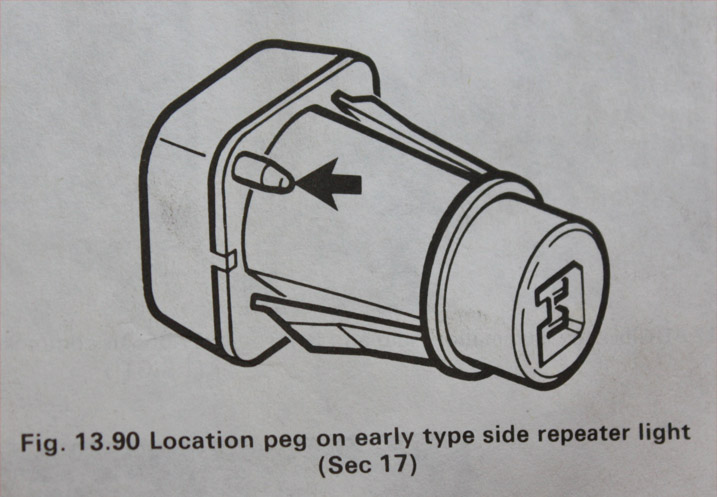

humanz 3 Posted January 9, 2010 http://cgi.ebay.co.uk/Peugeot-205-Side-Win...=item35a1cfd154 http://cgi.ebay.co.uk/Peugeot-205-Side-Win...=item35a1cfd40b Not sure if these will be active links as I've never done this before but this shows the two different sizes of the side repeaters, but the parts avaliable for my model year list to different parts, wodering if its the size difference or mounting methods? The part numbers reflect the mounting methods. Both of those repeaters are for the twist and lock holes (odd shaped holes). Both are what I would call ph1.5 or ph2 repeaters. The repeaters with a locating lug (ph1 repeaters) are totally different (the white part that actually goes into the hole). Will take some pictures and put up. Share this post Link to post Share on other sites

humanz 3 Posted January 9, 2010 The repeaters all use the same bulb holders, so you can use the holders you currently have. Here are those pics I promised. My computer's been really slow today. Should be a little clearer now. The later style repeaters came in two sizes: a small size identical in size to the early style ones, and a later larger size. But, both later style repeaters have the same locking mechanism. The early style repeaters had a plastic spring mechanism and a locating lug (as in the drawing). If your hole is the same as the one in the photo, you need a later style repeater. The size is your choice. I converted my ph1 holes to the later style ones, and I rather the bigger sized later style repeaters. Here's a gratuitous photo of my 205 with my smoked later style repeaters. Taken when it was clean. Share this post Link to post Share on other sites
grandos 16 Posted February 12, 2010 Right ordered some of the 24 part number repeaters and they are indeed the earlier style with the locating lug push fit type. (No good for mine) The other 59 part number repeaters are for the twist lock fitment but are the larger size (smaller twist lock has not even got a mention or part number) So it looks as though I'm now stuck with the larger size repeaters. (ordered and paid for) Share this post Link to post Share on other sites
