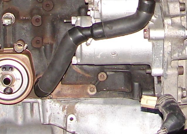

If these are the dished RGX pistons, what are on my pic? My engine is out form a 96' Xantia TCT, the RGX can be easily read on the block where the engine number is.

Engine code should be to the right of the oil filter, just above where the block is attached to the sump - or it is on the 2 RGX lumps ive seen.
Jamal
your block even looks different to mine Jamal. Ive never seen an engine code on mine though.
It's on the front of the block under the starter motor, near to the oil inlet, above the sump, engraved into a flat surface
Only can see PSA on the pic

Yeah, I will take a pic about it. Somehow :D

Had a look there mine is RGX alright. Pistons are dished with a flat bit on side (rear) only. front of the dish is curved. So guess its alright then

Mine is RGX too.
