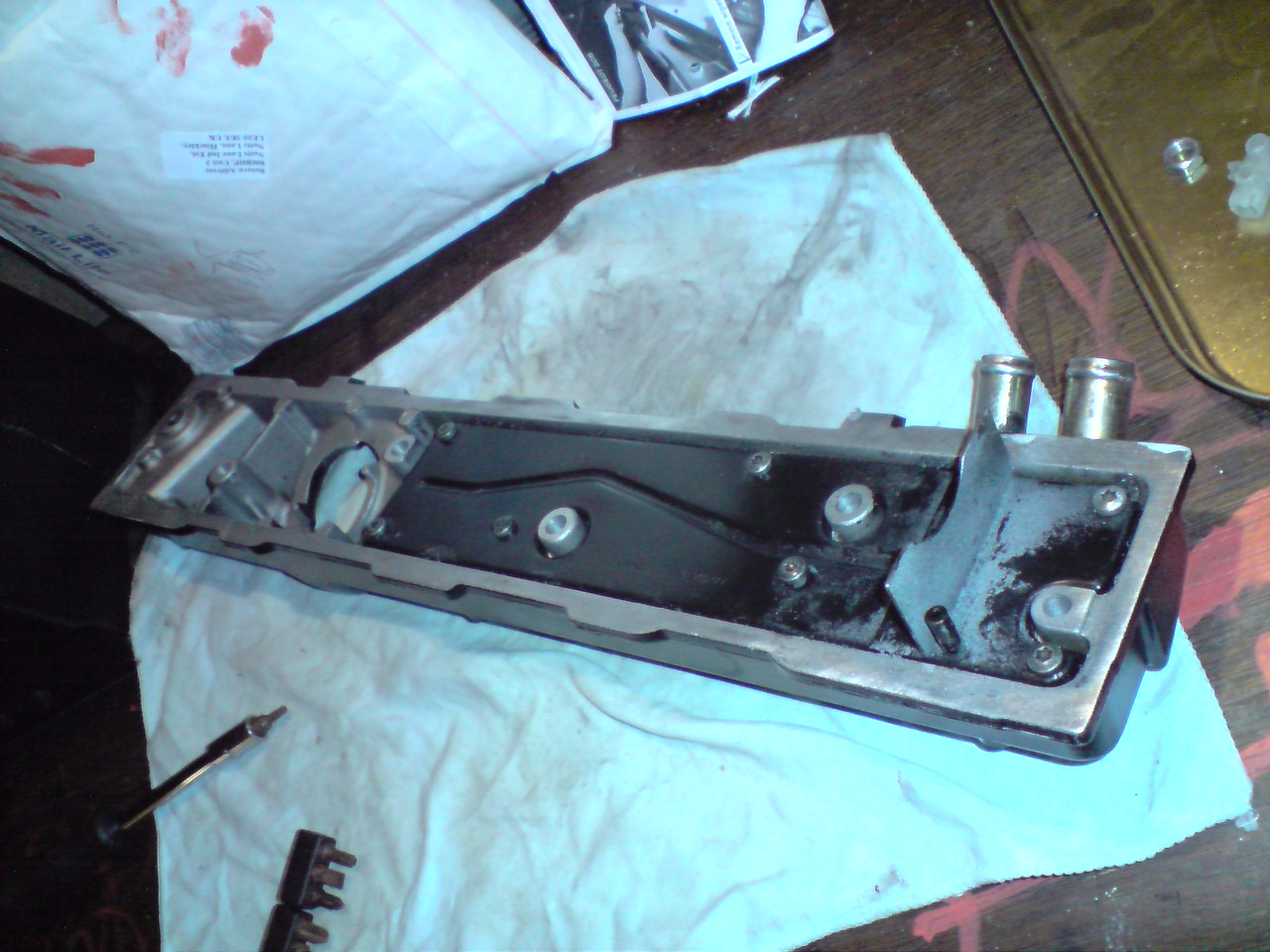

Also, Should I take the black plastic part of to clean it??

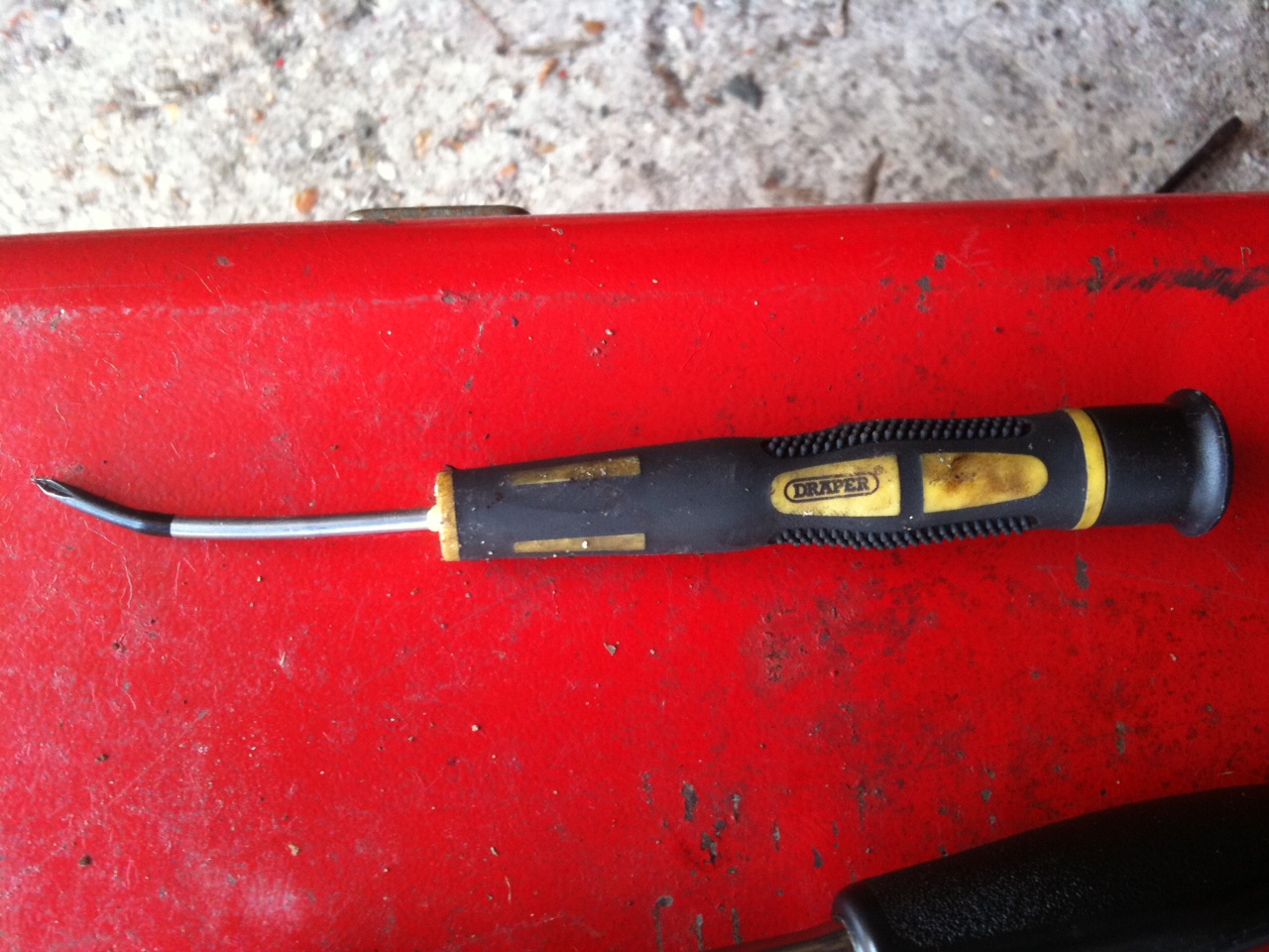

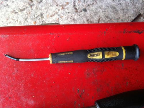

NeilGTi85
There are a few ways to remove the pin, I re-angled a small screwdriver so that I could tap it through from the back, with abit of wd40 it came out nice and easy. (I'll get a pic of my invention)
The main reason I removed it was due to space restrictions and I dont think its really needed, the old engine that I used did not have one and never overheated.

This is what I did to get the pin out -
