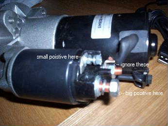

this is a bit hard to see but it the best i could do. :(
with the negative attached on the gearbox. put a main positive feed on to the(big positive here) post. then when you want it to engage and turn the engine over add a positive feed to the(small positive here) post. whether you get the second feed from the battery or the first post it dont matter.

So as people have said:
Battery neg>>>>big lead>>>>attached to gearbox or engine block
Battery pos>>>>big lead>>>>attached to one of the two large posts on the solenoid
Then to trigger the starter, either bridge (with a plastic handled screwdriver) between your positive cable on the solenoid to the spade connector on the solenoid, OR, take a smaller wire from the positive battery terminal to that spade.
Leave the alternator alone; it's not fitted, and it's not needed for this test.
Good luck mate.
