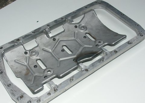

The sump from an xu10 engine is deeper and is baffled, this sump fitted with an extended oil pick up is the cheapest way to battle the dreaded oil surge effectively.
dcc
I think its only the xu10j4rs which has the baffled sump (well single windage tray - not exactly baffled :)) found on gti6 and xsara vts engines.
All alloy XU10 sumps are baffled. I did an oil capacity test last weekend. An XU10 sump, with my modified XU9 spacer plate and windage tray below, will take 7.3L of oil and just lap under the windage tray.
