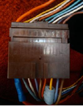

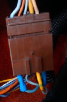

this is my 9 pin plug
from left to right.
thick red wire - starter motor solenoid
grey - coil pack
white - ???
purple - reverse or nothing. cant remember which.
brown - reverse or nothing
red - oil pressure#
yellow - nothing
blue - nothing
blue - nothing
left to right also
blue - coil pack the yellow wire on the coil plug.
grey - coil pack different pin on coil plug
earth - alternator

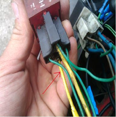

black wire begind the blue crimp - tachy relay arrowed to the pin its conencted to.

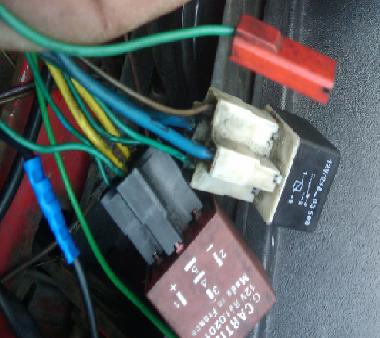

is this the correct relay pin to connect to? i used the 405 wiring diagram in the haynes to find it.
and where does this one go? it comes from the loom which the relay wires come from?

ignition switched feed i have taken from the tachy relay which ends up at the coil pack. is this the right pin on the relay i have the swithced live too?
and where is the best place to put the earth from the brown multiplug?
Aaron
Edited by A2TheA
You shouldn't need to take the ignition switched feed from the tachy relay plug, just directly from the brown plugs under your dash (coil wire # 2A iirc).
Has the igntion module plug got a seperate ring terminal out of the plug? If it has, this is an earth & has to be bolted to the chassis for you to get a spark. (also means its a BX loom iirc).
I never changed the earth from the brown multiplug, engine loom earths to the gearbox stud & thats was fine but I can't see an earth wire in your brown plugs pictured above. They are a bit small though.
