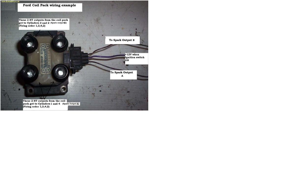

could be , i'm just going by this:
its out of the ms manual
bingo! that's the problem I reckon, Ford number them the other way :lol:
bloody hell, you'd think that on the website selling the ecu's they would have this info correct.
but does ford not have the same firing order just reading from the other end of the block?so 2-3 will still be in the middle?
no matter anyway i'll give it a bash,ooooh i'm quite excited now...wish she fire or wont she :)
thinking about it you are right because its wasted spark it still doesn't matter, DOH!
would still confirm they're on correct though.
