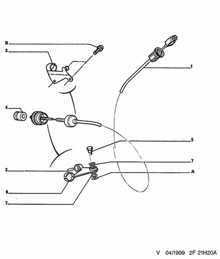

does anyone have a picture of the mi g/box especially where the clutch cable joins it.
I think im missing something as i can pull the cable and the pedal moves but it wont return to its normal position. im not to familiar with this so any info is mucho appreciated.

Definitely sounds like a BE1 mechanism, quite likely for a roughly 30mm long rod to be missing between the lever that pivots on the gearbox and the clutch release lever itself.
it often falls out as there's meant to be a spring holding the clutch lever to the pivoting arm but is often missing so the pin falls out when the clutch cable is removed or snaps.

Even if its a Be1 Mi gearbox I don't think they had the rod, the one I removed to replace a clutch on didn't have & iirc they all have the Be3 style clutch mechanisms.
Graham.
it could be a 1.9 or 1.6 box, not an Mi16 one if it has the arm poking out of the bellhousing, but without a picture its hard to say what you'll need.
Mi16's I think like Graham says only have the release fork and arm on the top end of the shaft.

A Be1 can be either a 1.6, 1.9 or Mi but if it has the set up as shown below on the gearbox cable end you need the small rod item #2 but its not an Mi gearbox.
Graham.
philfingers
looks like this the little rod, as you can see lockwiring it in place stops you loosing it!
putting the standard fit spring on there does it too :lol:
