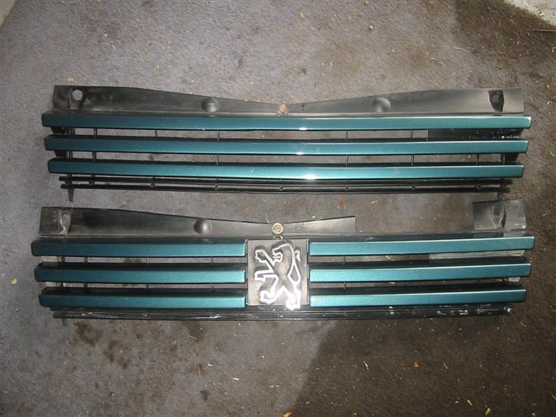

MerlinGTI 3 Posted July 26, 2009 Absolute pain in the ass to get right, theres about 10 hours work on that grille all in, and thats with all the propper equiptment at hand. I chopped out the center section of the grille front, plastic welded in some donor slats, then plastic bonded them with mesh and adhesives for strength and flexibility, filled with plastic filler. Then I had to attack the grille backing with a die grinder so the square in the center for the badge was slat shape... matching the new front section. Sounds easy but I wouldnt want to do another Share this post Link to post Share on other sites
joe1joe 3 Posted July 27, 2009 (edited) that sounds a long winded way of doing it??? as u are more likely to change the shape of the grill if u remove the middle bit??? i jst removed all the paint in the centre bit (the badge peice) and ruff the platix up with grinder bit in drill and corse paper, then used another grill and stuck in peices from another grill using fibre glass filler and "v" ing out all the peices to prevent any lickly hood of cracks...... and then a light skim with fibre glass filler over each bar, and had it so close once it was finished needed no body filler only fill stoper...... and the peice between each bar (only the bit where the badge was) i painted black as removing this would weaken the grill to much. Edited July 27, 2009 by joe1joe Share this post Link to post Share on other sites

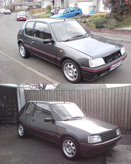

Baz 421 Posted July 27, 2009 (edited) Mine, i'm not a massive fan though. Edited July 27, 2009 by Baz Share this post Link to post Share on other sites
MerlinGTI 3 Posted July 27, 2009 that sounds a long winded way of doing it??? as u are more likely to change the shape of the grill if u remove the middle bit??? Prevents you from seeing the square backing, its not removed but cut into the same shape as the bars. Didnt 'change shape' and still retains the center mounting locater thingy. Share this post Link to post Share on other sites
pugdamo 111 2 Cars Posted July 27, 2009 Heres mine,its the only grill i think suits the 205 (other than the standard one )but thats only my opinion Share this post Link to post Share on other sites
Fox 3 Posted July 27, 2009 I've been 'making' one of these for a few months now, do an hour now and then, then get bored... Its really hard Share this post Link to post Share on other sites

joe1joe 3 Posted July 29, 2009 does look nicer with the bit removed from inbetween each bar, i just thought it would be a bit weak.... looks a very tidy job u have done though. Share this post Link to post Share on other sites
