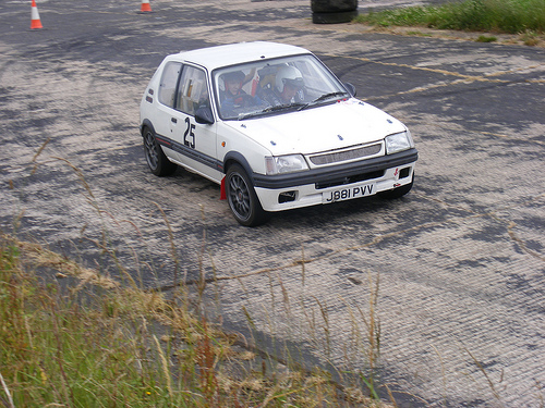

jimmer
after doing three counties stages yesterday at smeatharpe my arms chest and stomach were killing cos of the endless 90 degree corners. too much going on at once, braking finding first gear and trying to steer at the same time :wacko:

maxirallye
Jimmer at the weekend, steering not too much of a handicap, lying seventh overall and second in class against some VERY quick escorts, prior to terminal engine failure :D
