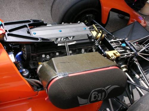

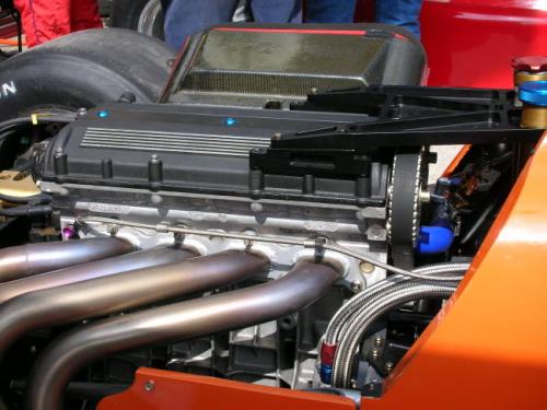

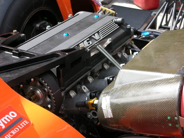

edit: added pics of Mi16 sitting upright in kitcar... I think the name of the kitcar was Pell Genesis.

I found the pics I took on my crap phone at the time, less that I thought but never mind:
