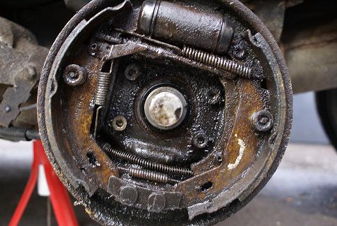

manrajf 0 Posted June 18, 2009 Hi everyone cheers for the replies, i finally got the bugger off, i used the putting the wheel on and pulling while rotating method and it worked like a charm. Also everything came out intact nothing broke or snappped, but it was full of oil in there so had to give it a proper clean. All im waiting for now is a new cylinder from gsf and put it back on. also since the bearing is in the drum is it hard to get the drum back on the stub axle? thanks manraj Share this post Link to post Share on other sites
billybluesky 1 Posted June 18, 2009 Hi everyone cheers for the replies, i finally got the bugger off, i used the putting the wheel on and pulling while rotating method and it worked like a charm. Also everything came out intact nothing broke or snappped, but it was full of oil in there so had to give it a proper clean. All im waiting for now is a new cylinder from gsf and put it back on. also since the bearing is in the drum is it hard to get the drum back on the stub axle? thanks manraj oops it all looks a bit brake fluidy in there make sure your brake shoes arn`t contaminated too much if there`s only light contamination you can clean them up with brake cleaner but if they`re soaked you could do with replacing them also i recently had a sticking drum it turned out to be the bearing was tight on the shaft i just cleaned the shaft up with some emery and it was ok Share this post Link to post Share on other sites
ablister 31 Posted June 19, 2009 if the cylinders were leaking so badly as to be noticed in a mot then the shoes will definately need replaced. Share this post Link to post Share on other sites
billybluesky 1 Posted June 19, 2009 just a quick note to anyone who has to replace rear cylinders i always unbolt the cylinder from the backplate then holding the brake pipe nut with a spanner turn the brake cylinder to undo it thereby not ripping the end offf the brake pipe Share this post Link to post Share on other sites
Tom Fenton 1,525 Posted June 19, 2009 Those shoes look to need replacing. I wouldn't chance reusing those. Share this post Link to post Share on other sites
manrajf 0 Posted June 20, 2009 Hi all the job is all done now, i got new shoes and replaced the cylinder, bled the sytem and everything is ok now, all i need now is for it to pass the MOT and jobs a good un cheers manraj Share this post Link to post Share on other sites
