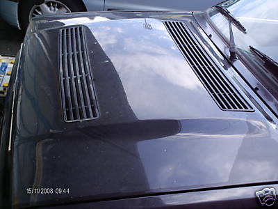

ecosse do a bonnet that has the 2 delta vents in it,
they should be able to supply the vent on its own i would imagine.

the ecosse bonnet is an RGM vent skinned on top of an OE bonnet. you used to be able to buy the vents on their own direct from RGM, but they're nothing like Integrale vents :D
RGM also used to do a more OE looking integrale vent, but it wasn't functional, no idea if they still do them or not
ablister
i have that ecosse bonnet, it was the one from the famous steel grey ecosse 205 on throttle bodies, and it's just a std bonnet with the moulding on top so has no extra clearance underneath. Looked nice if you like that sort of thing

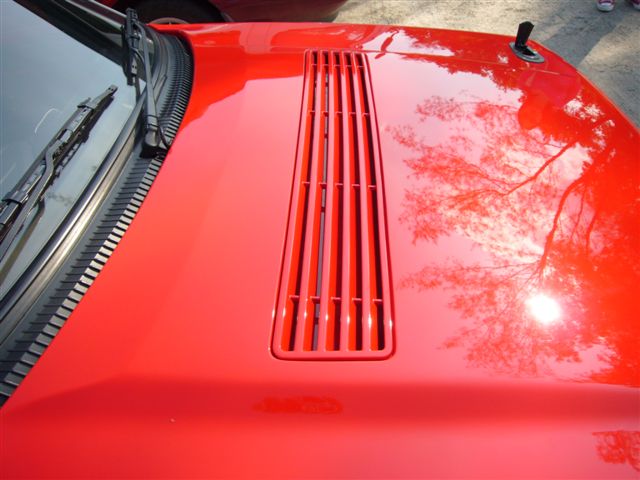

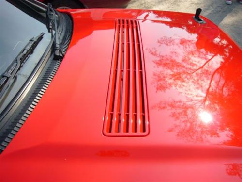

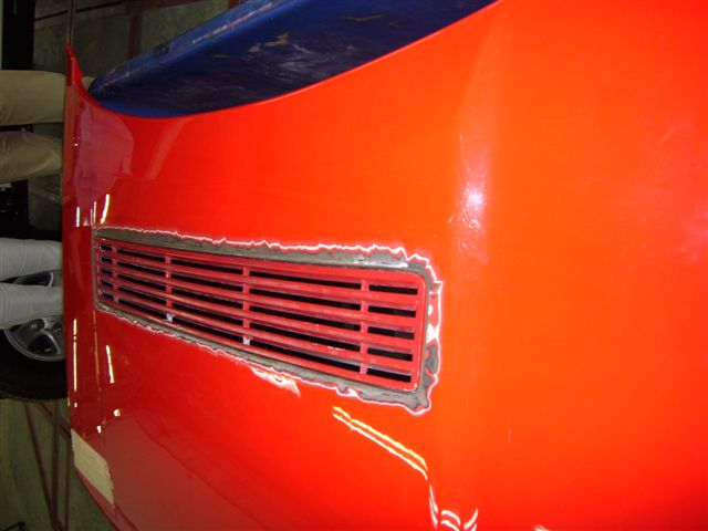

at last I have bought a vent from a British guy in ebay. it is from a Lancia Delta 16v. the bodyshop got it half way done, a water drainage pan is on the way and after that a full bonnet respray.
unfortunately we couldn't place it any higher due to the line across the bulge, making too close may ruin that line.
it will be functional and is what I have been longing for a long long time since I first saw a Lancia Delta Integrale. :lol:
what do you guys think of that vent?
paul205mi16
Would like to see on the car sprayed up, but looks good.
omega
nice work
large
I like it. I think it wil work well with the car.

joe1joe
looks very smart, i also looked into this when sorting the body work out, and the way u have done it means no CRACKING filler due to heat etc! how is it actualy held in?

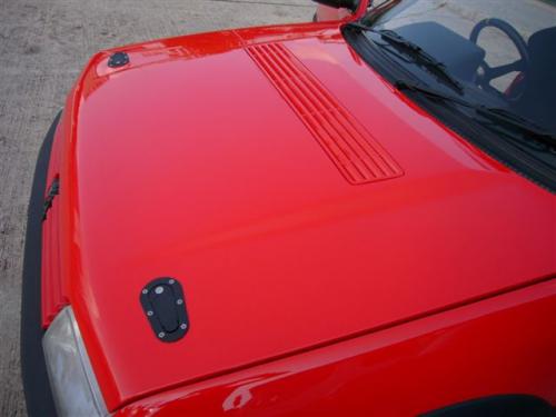

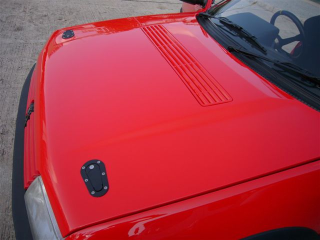

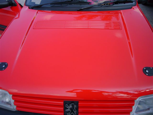

here it comes
DaveW
That looks really good :)

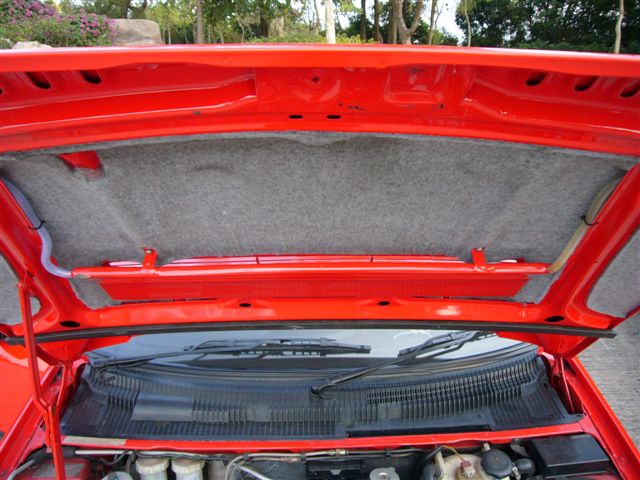

BusEngineer
Whats the hosepipe for in your bonnet? Looks a little large for washer tubing
Bonnet looks awesome, how much has it cost you to do?
Daviewonder
The hose is for the rain to drain away when it comes through the vent :)
Looks smart!
BusEngineer
Oh i see, clever :)
engine killer
without those hoses, it will flood the spark plug sockets and..... nightmare! (I had serious misfire due to wetted plugs)
