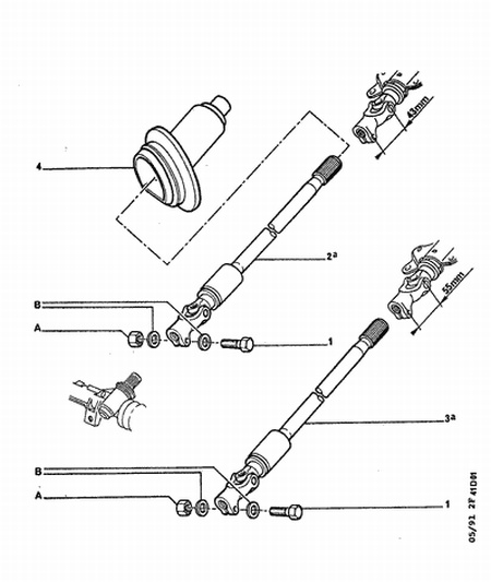

- Lower steering column - Peugeot do them but there are 2 different types one £70 the other £130. My PAS rack is off a '90, but no idea which to buy. People have the parts, but usually are unwilling to sell the column without the pump and rack included. Bah.

New lower steering column for PAS upgrade. Still cant work out which to buy. There are 2 types and I cant work out which I need. The rack is off a 90 GTI but I need the VIN or reg to find out which I need. Had a look on servicebox and found the diagram but as I dont have the upper part of the steering column from the original car I cant work out which I need. Peugeot said I am obligated to buy the part even if its wrong, and I really dont want a £70 lower column I dont need. The differences in the two racks are to do with the top column and the distance between the unions (450mm and 550mm I think) Has anyone got a '90 GTI with PAS? Can you measure the top column unions for me!!!!?

Finally got a lower steering column off a bloke selling a rack on ebay £20. All I need now is the hoses. I went to peugeot but they came up at £60 a set and the special jubilees are a 50 pack!!! So Im just gonna go to an autofactors for that stuff.
