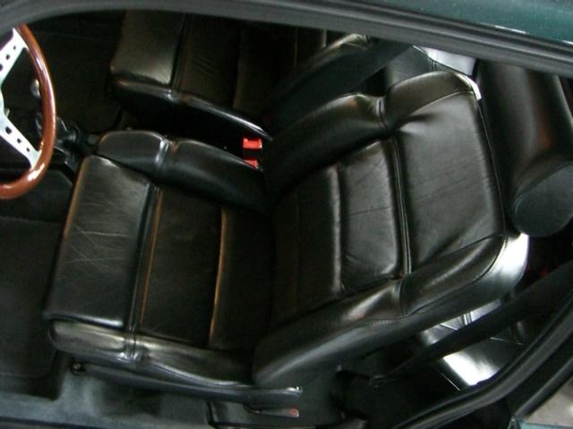

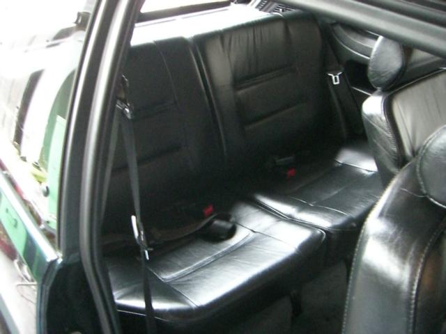

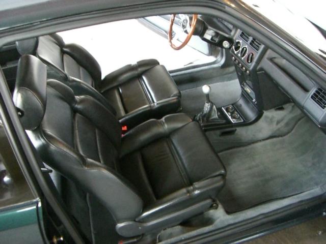

Gentry_Ba
hi!
very nice results with liquid leather, I'm amazed! :(
when my seats gonna wear, I will try it!
if your seats have only minimal wear, then you can try to bye some horse-stuff. The last years I always used expensive stuff, but nothing worked as good as the horse-stuff! (and this is very cheap!) :angry:
here a few pictures of my 205 gentry leather interieur (after using horse stuff...) - now the car is garaged, it only runs 5 month a year.
(...and yes, I know, my steering wheel is on the wrong side... :lol::lol: )
