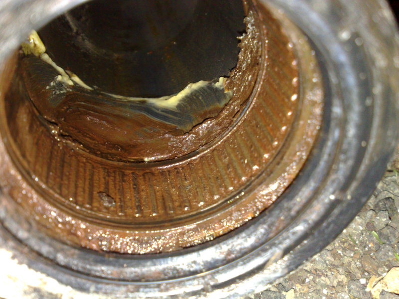

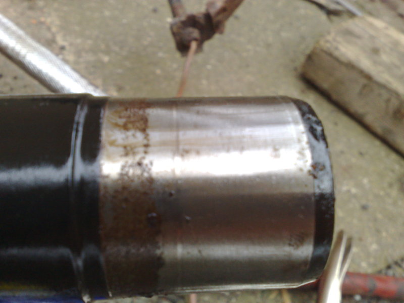

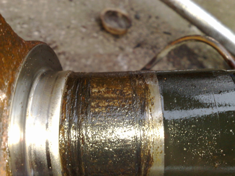

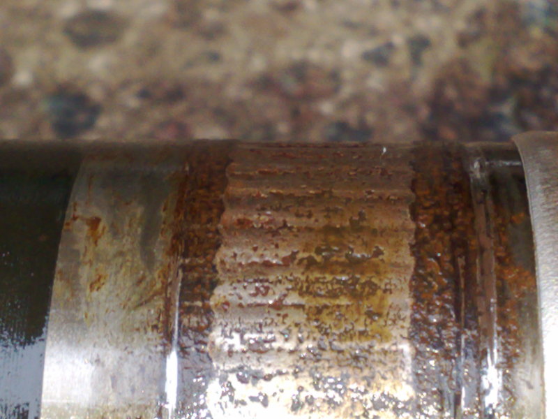

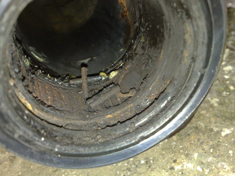

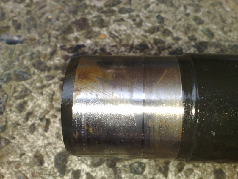

dino20vt 3 Posted April 6, 2009 Im guessing the outer bearings have had it, dont think the inners have. What can I do about the shafts? Share this post Link to post Share on other sites
Anthony 1,000 Posted April 6, 2009 Both shafts are past it and need replacing I'm afraid, although it looks like the tube should be fine with some new bearings/seals Share this post Link to post Share on other sites
dino20vt 3 Posted April 6, 2009 Both shafts are past it and need replacing I'm afraid, although it looks like the tube should be fine with some new bearings/seals Got any?! Share this post Link to post Share on other sites
