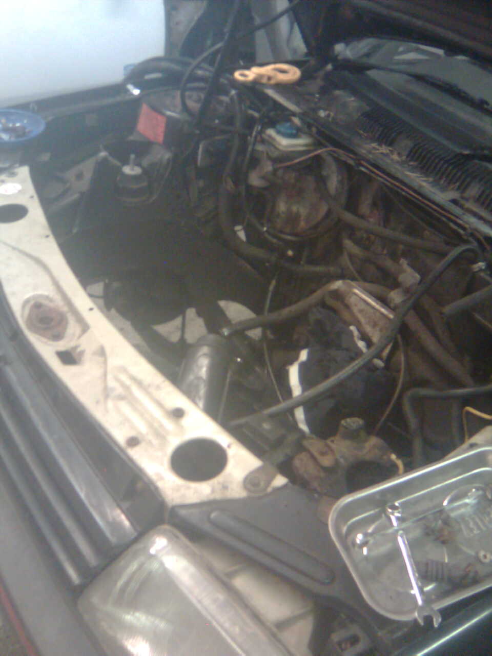

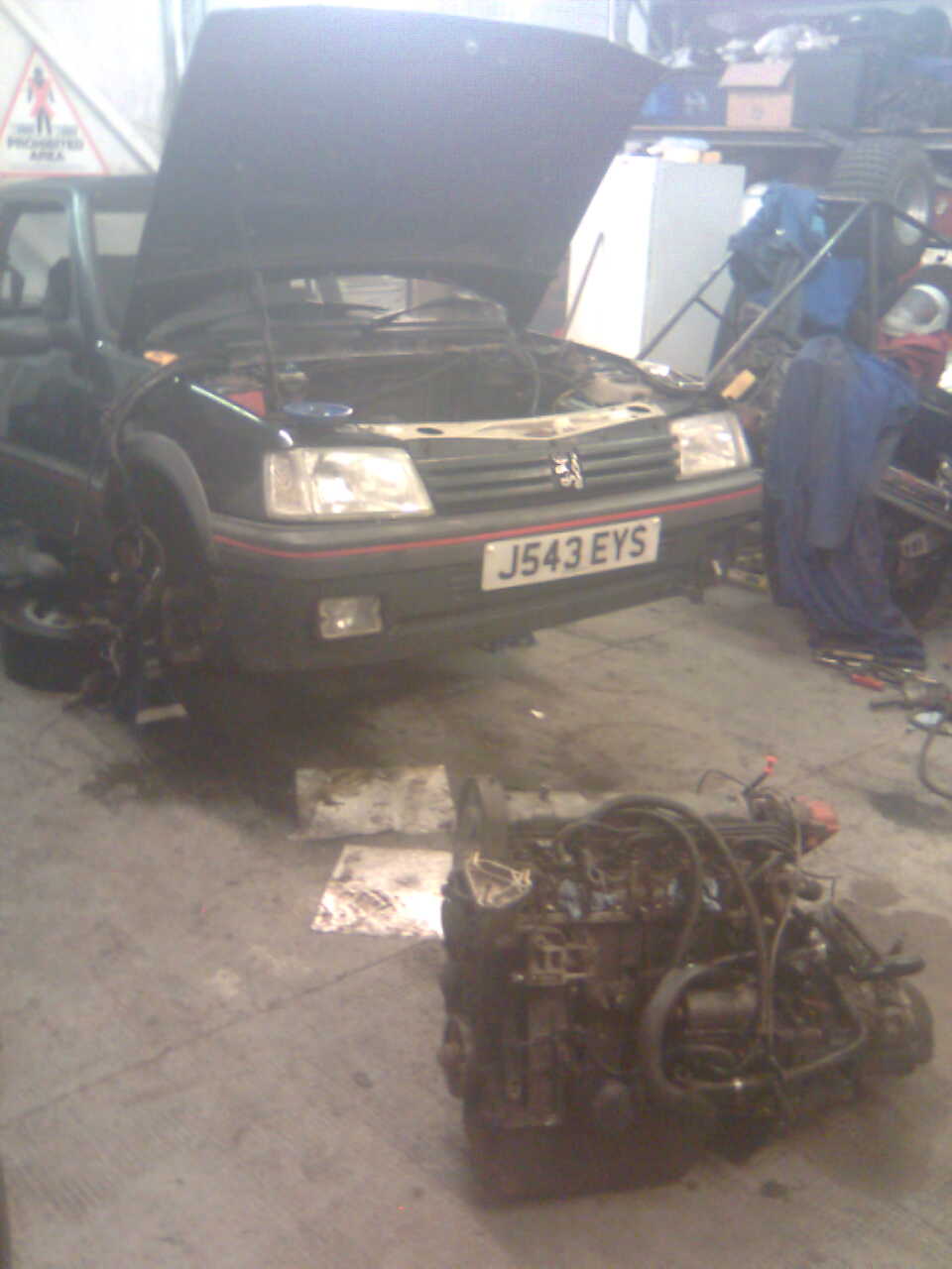

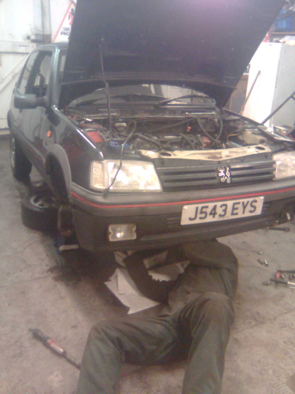

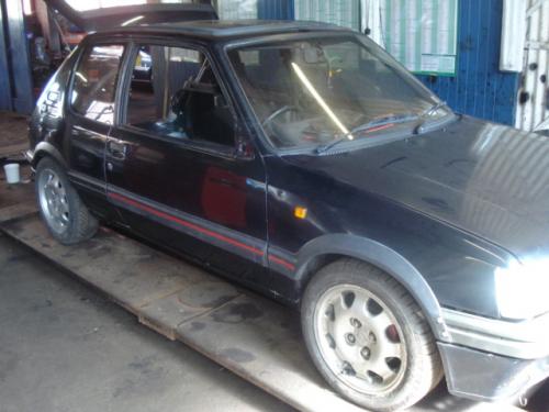

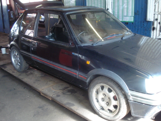

The car had some earthing problems, Once I had sourced new battery terminals ans soldered them together she was running... albeit very very smoky...... so down to a mates workshop to diagnose the smoke problems and check it over properly!!! Unfortunately the engine was bruning oil an awful lot so.... out with the engine.....
in the 'shop
me under car.... god I wish I had a ramp!!

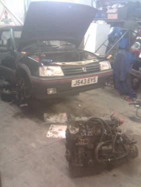

out!!
engine dragged out from under the car and left!!

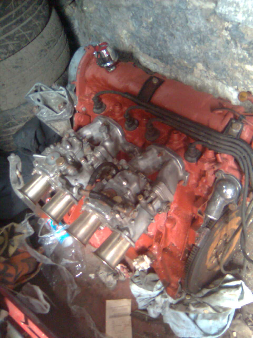

on the search for an engine I came across this!!
post-6256-1237986173_thumb.jpg :lol: 45s!!! oh yeah!!
But one of the liners turned out to be cracked... Sold the carbs and manifold.... then continued to look for an engine...

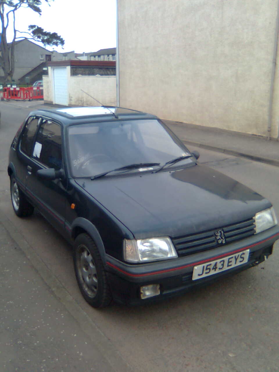

Pulled well in all gears and was great fun!!! 1.6s rock!! :blush:

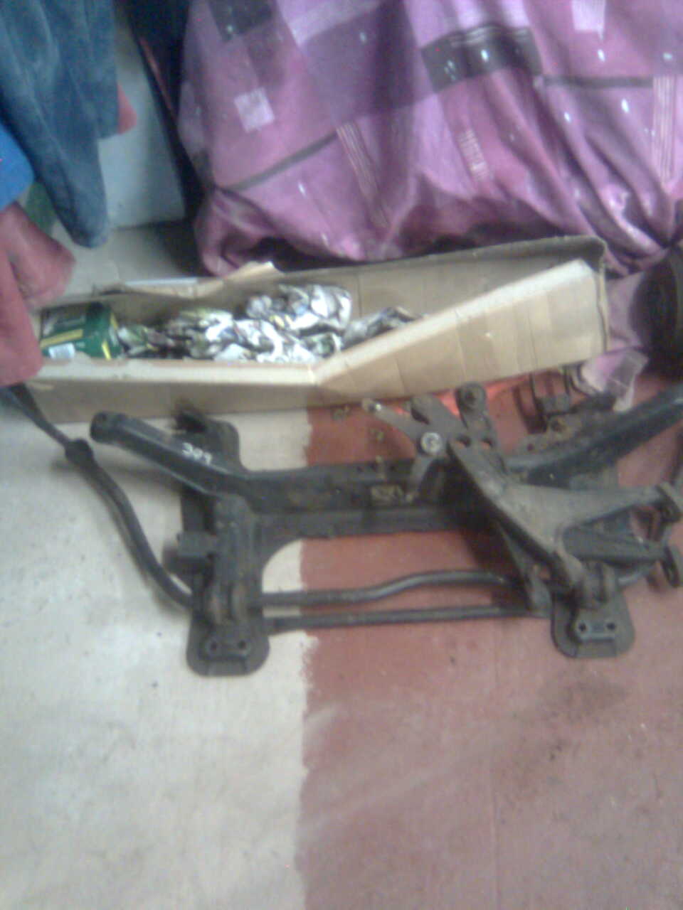

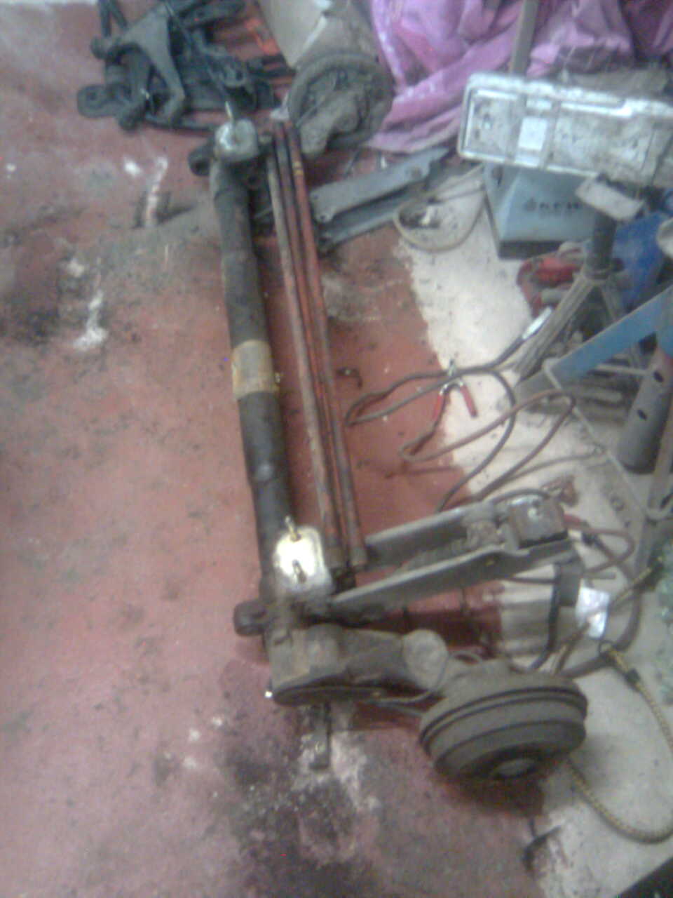

base model 309 beam!! 30 quid from a local breaker!! add 309 t/bs and arb from stock!!
309 gti front subframe with arb and good wishbones...... coupled with some 309 gti shafts and 1.9 hubs and struts!!

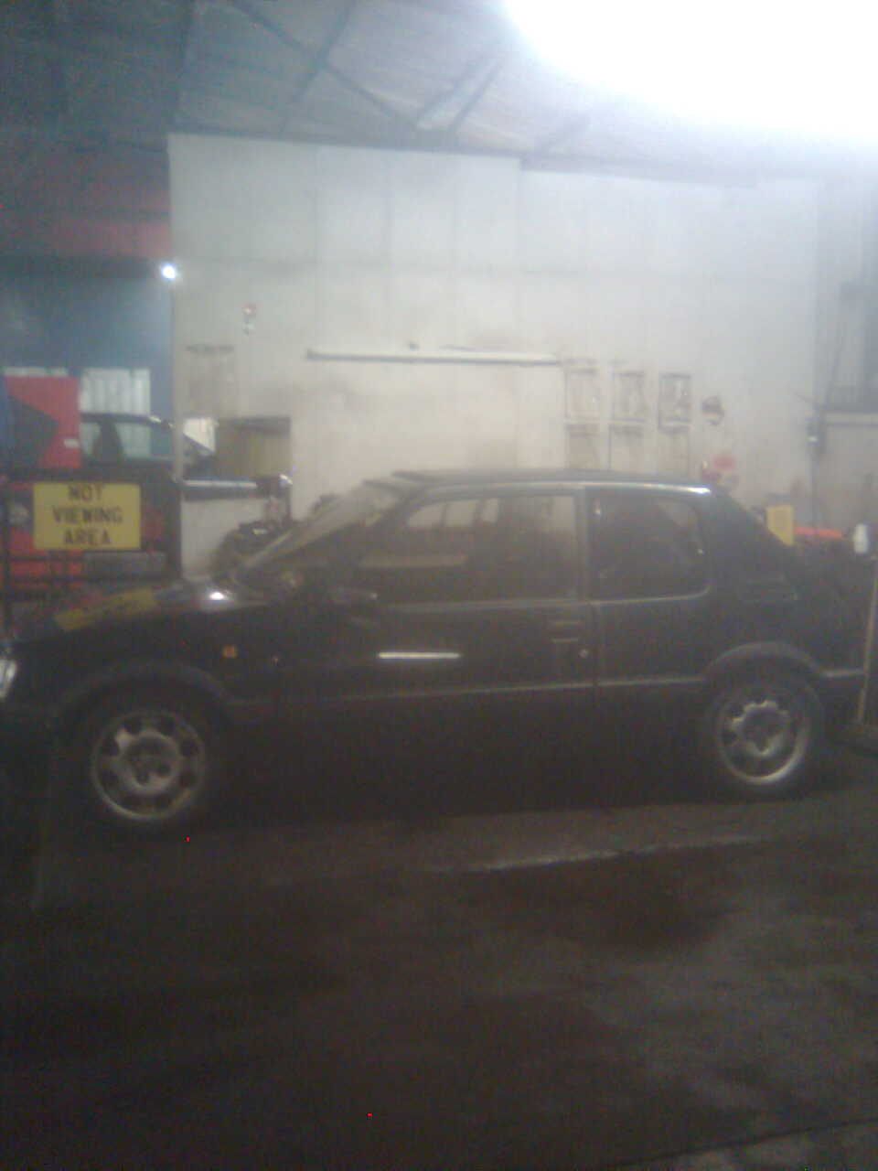

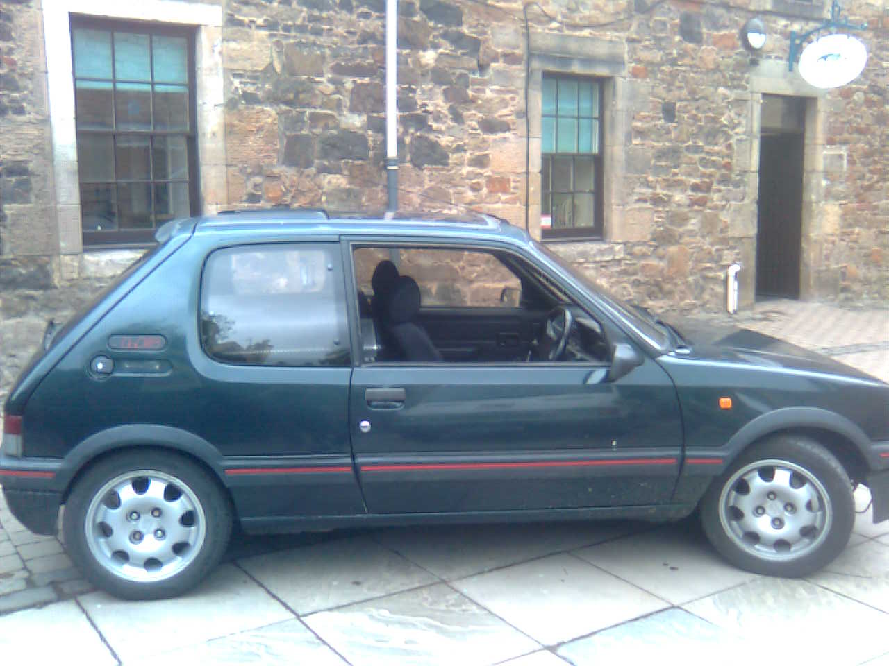

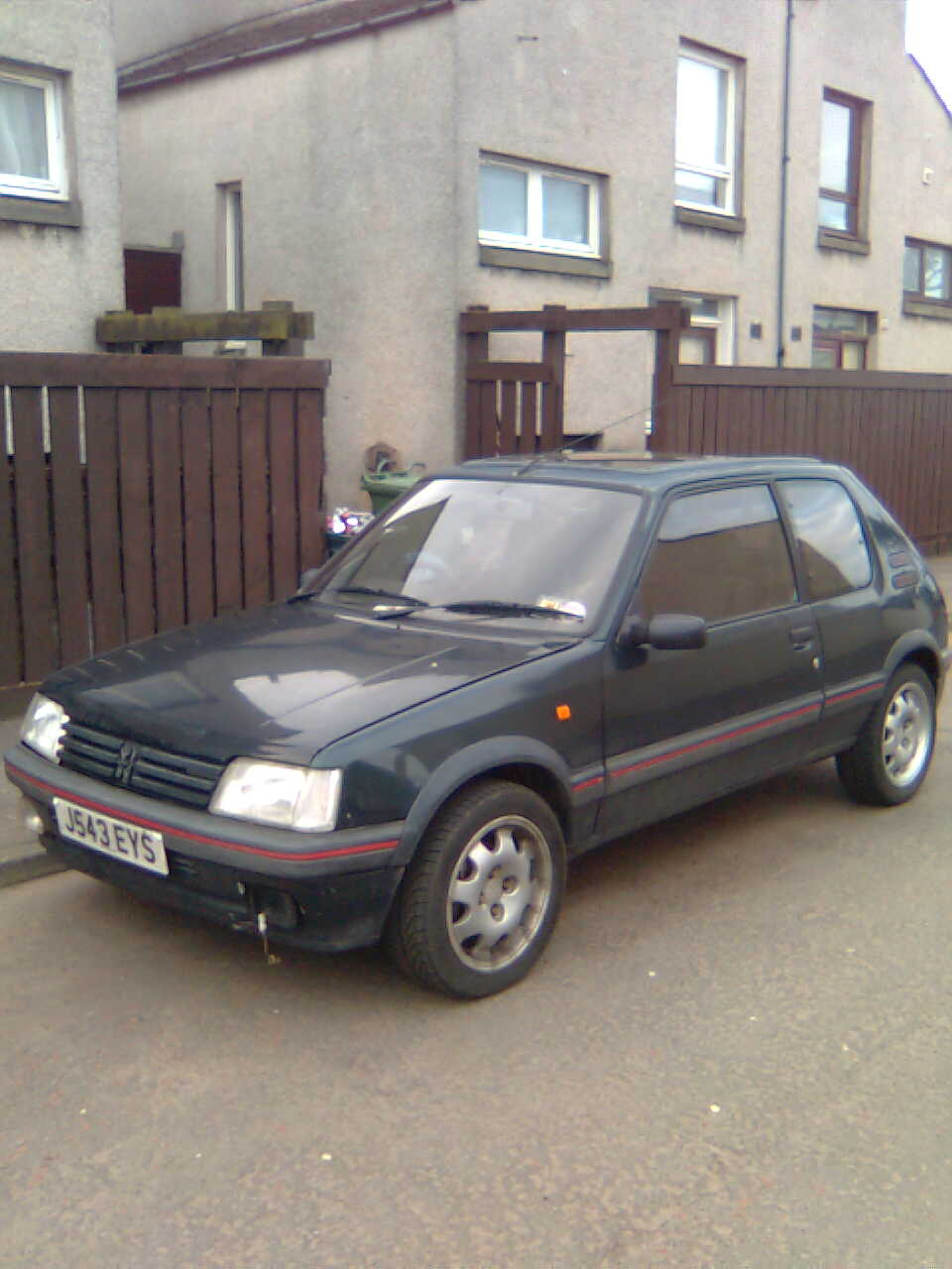

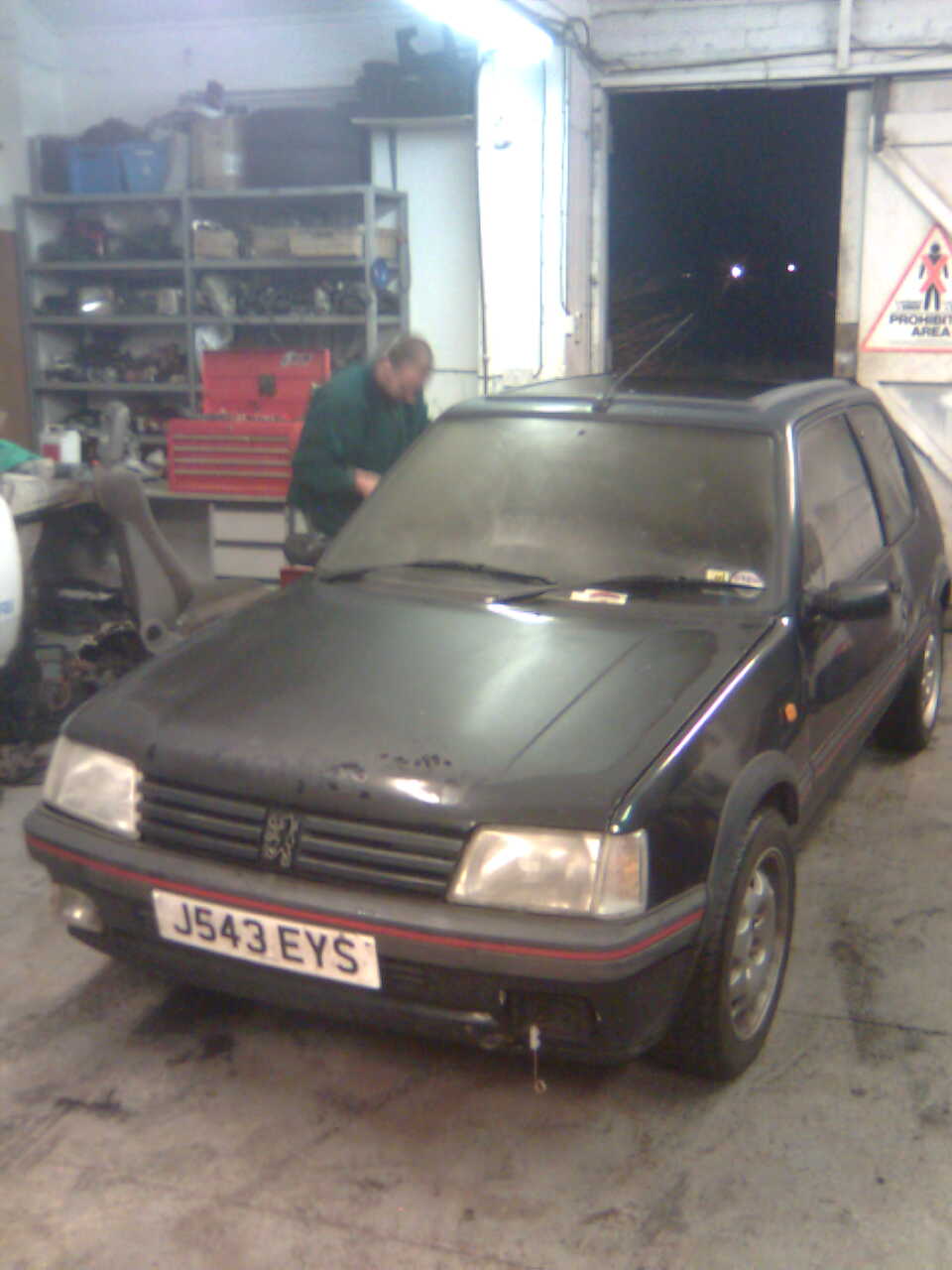

Eventually got it all together and she sat in my sisters drive for a while... uni was alot of work and I have some cash flow problems, :lol: after a few weeks got her down to a garage that I help out at to prep for MOT ;)

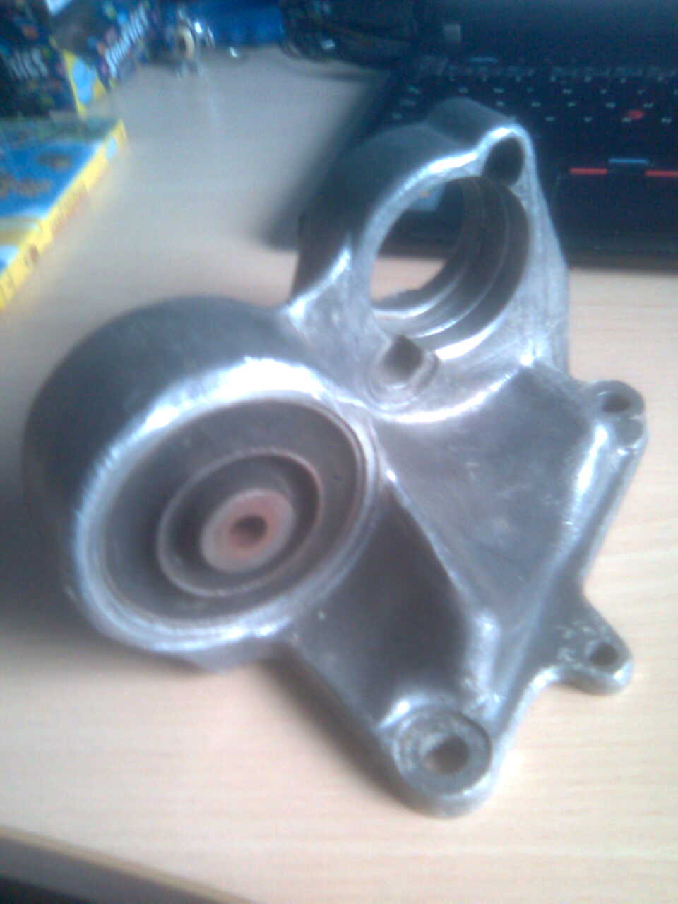

Solid Rubber bottom mount!!

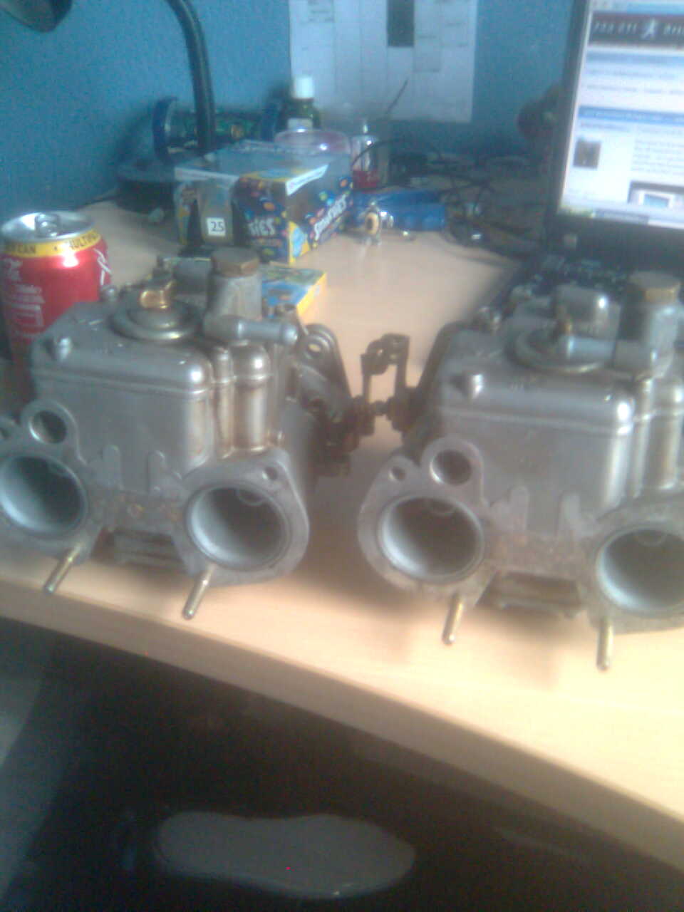

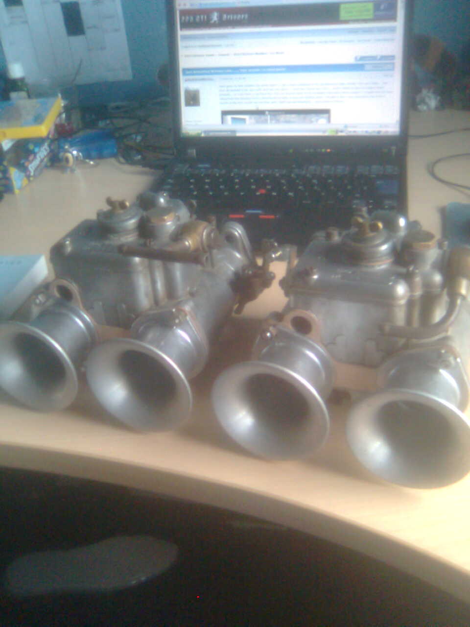

DCOM 40s
DCOE 40s

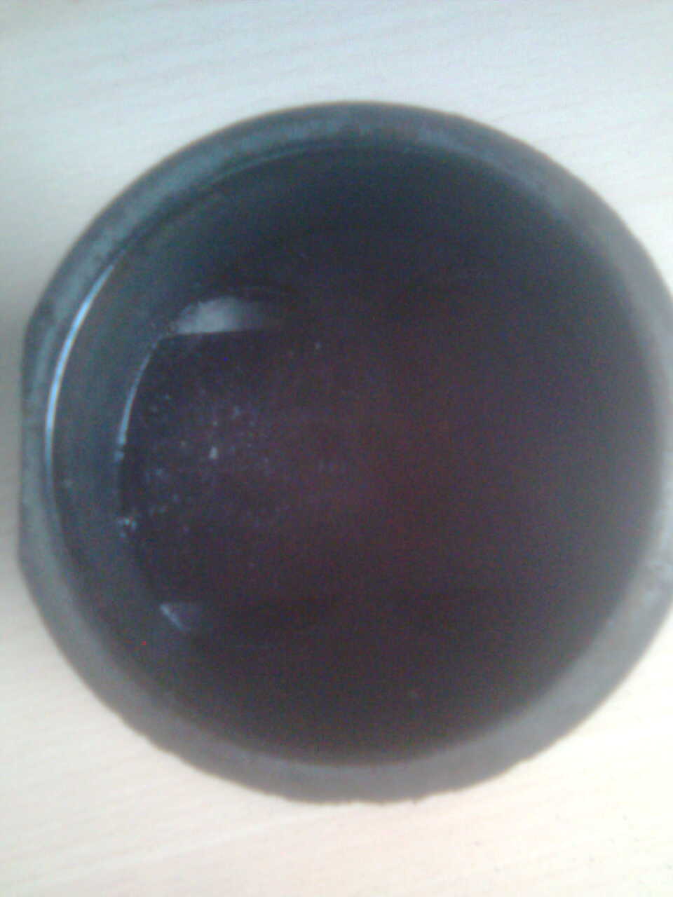

Set of Mi liners and pistons!!!!
I am unsure of the difference between the carbs,Will be rebuilding the DCOMs and still trying to find a manifold for an 8v for them.....

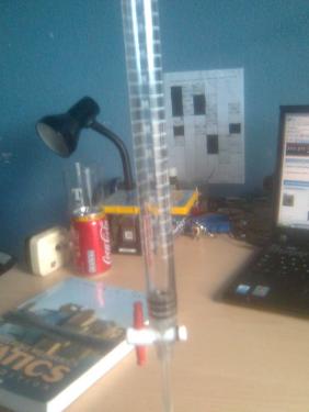

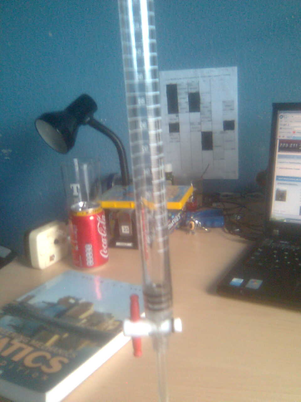

Also got a burette, for measuring combution chamber volumes..... I love getting things in the post!! rather get 205 bits in the post than s#*tty socks for christmas!!

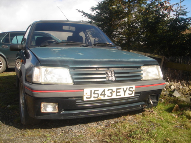

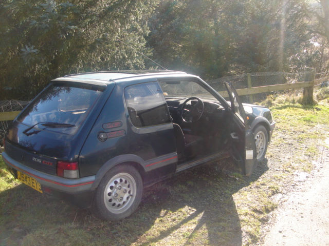

Here's a couple of pictures of it the day my dad and i rescued it from a farm i used to pass on my way to uni.
Took HOURS to get those damn drum brakes unstuck!

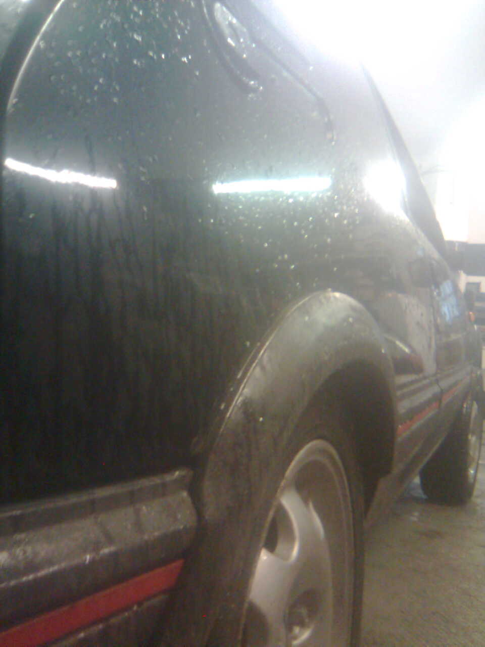

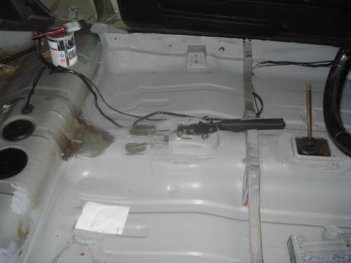

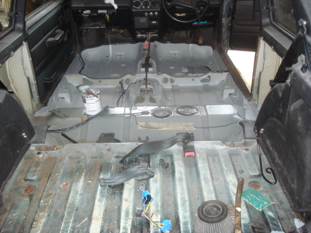

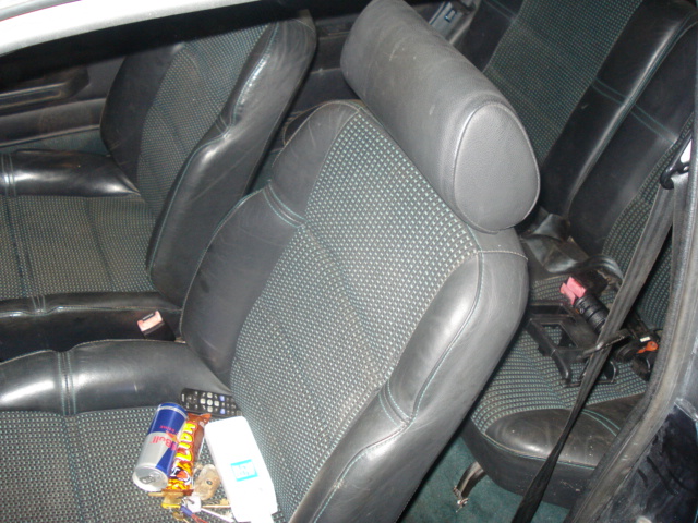

wqas doing some work to the car last night.... ended up washin her and found that..... I freakin love sorrento green :huh: its just so,so.... magical... anyway, was intending to weld some of the floor where at had cracked aroung the seat mounts, (joy) so finished off the freelander that I'd just built the engine for and the o/s/f brake was sticking. So much so that the thing was red hot after the test drive...
anyway, freed that off and checked the back brakes on that... needs everything.. .pile of scrap... I hate freelanders.
Eventually got that off the ramp and got mine on. Cut out the offending article and made up a new section.Tacked it in place all nice and neat... then realised there was no welding mask about. Had gotten to far to not do it so, very slowly started to stitch it together bit by bit... Aiming,looking away and welding til I had attached a decent looking seam all the way round!! braw! Then decided to give it the once over for MOT!! Got a wee list together for it...

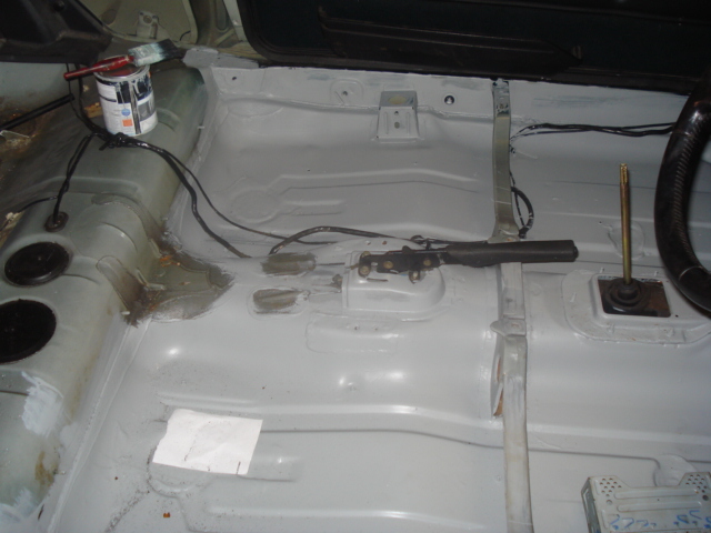

Take one 205
post-6256-1239469745_thumb.jpg :rolleyes:
paint recently repaired floor to prevent future rusting
