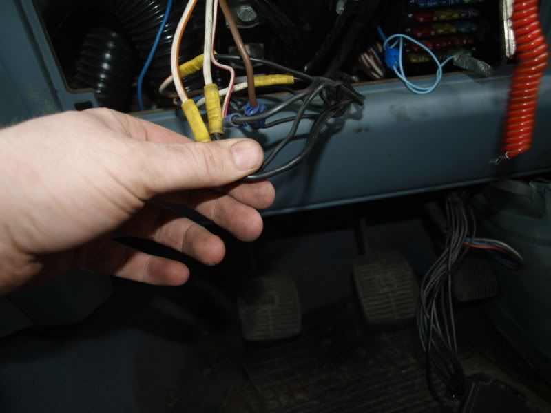

hexhamstu 9 Posted March 23, 2009 right finding the control box was pretty easy, was under the dash, and i have found 10 out of 11 wires, one wire im guessing is the live feed, but im not sure heres some photos. 2 of the black cables earth on the chassis.. 8 go to the ign switch http://i37.photobucket.com/albums/e100/hex...dy/P1010064.jpg and theres this extra one to the right of the smaller wires Share this post Link to post Share on other sites
hexhamstu 9 Posted March 23, 2009 AH that other wire goes to the ign key hole thingy whatsit. going to buy some yellow connecters now and bin this sack of s*ite. Share this post Link to post Share on other sites
Stu 18 Posted March 23, 2009 Id guess the one to the right being the bit that you poke the key in if its the 'key' type, or the transponder receiver if its that type. Obviously the two on the chassis are earth, trace the others to their respective wires, using a multimeter identify which are earth, live and switched live and that should leave immobiliser. So, if we assume its a two circuit immobiliser, there will be 4 that are immob. As you've got the colours, just follow either end of the colour if you get my meaning, that should be the 'broken' immob circuit, id join these together first as a test, then take the rest out once you're certain. Share this post Link to post Share on other sites
