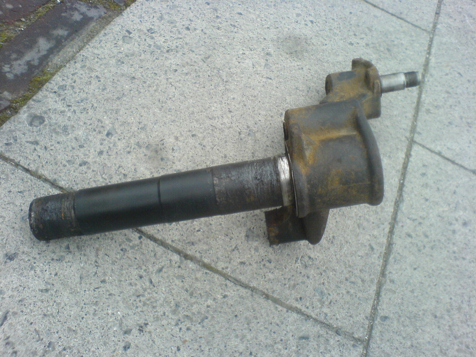

Hi guys, I need your help.
I'm in the middle of refurbishing rear beam, and I found something worrying :/ My english is not very good , especially the technical language so please be patient :) :/
What can be done with this ?
What should I replace it ? What's the name of it ? Can i took that apart or should I get the whole "yoke" .
That's the trailing arm shaft, and as per the shaft in your picture, they tend to corrode when they fail. That shaft will need to be replaced prior to reassembling the beam. Peugeot sell the shafts seperately although they're quite expensive (about £85), otherwise GSF sometimes have them available (about £40-45) or you can use the one from another rear beam if it's good.
The shaft just presses in and out, requiring about 6 tonnes of force in my experience.
Hope that helps.

Thanks Anthony, That mean that I can buy only that corroded tube, metal piece ?
Thats all you need to buy, the trailing arm as well would cost about £200 IIRC!
check the condition of the Crossmember tube where the bearings sit before you go any further though, damage there would neccesitate a donor beam which may have usable trailing arm shafts if youre lucky :)

Thanks , i was buying from him already , he is a great help but this time he was out of stock with those shafts. I've order one already from someone else. I should have it by tuesday here, and now it comes the tricky part B) I need some force to pressed the old out, hopefully I will be able to do this in local engineer.

yeah I just went to a local engineering place and got the new shafts pressed in and new wheel bearings done while I was at it :D
