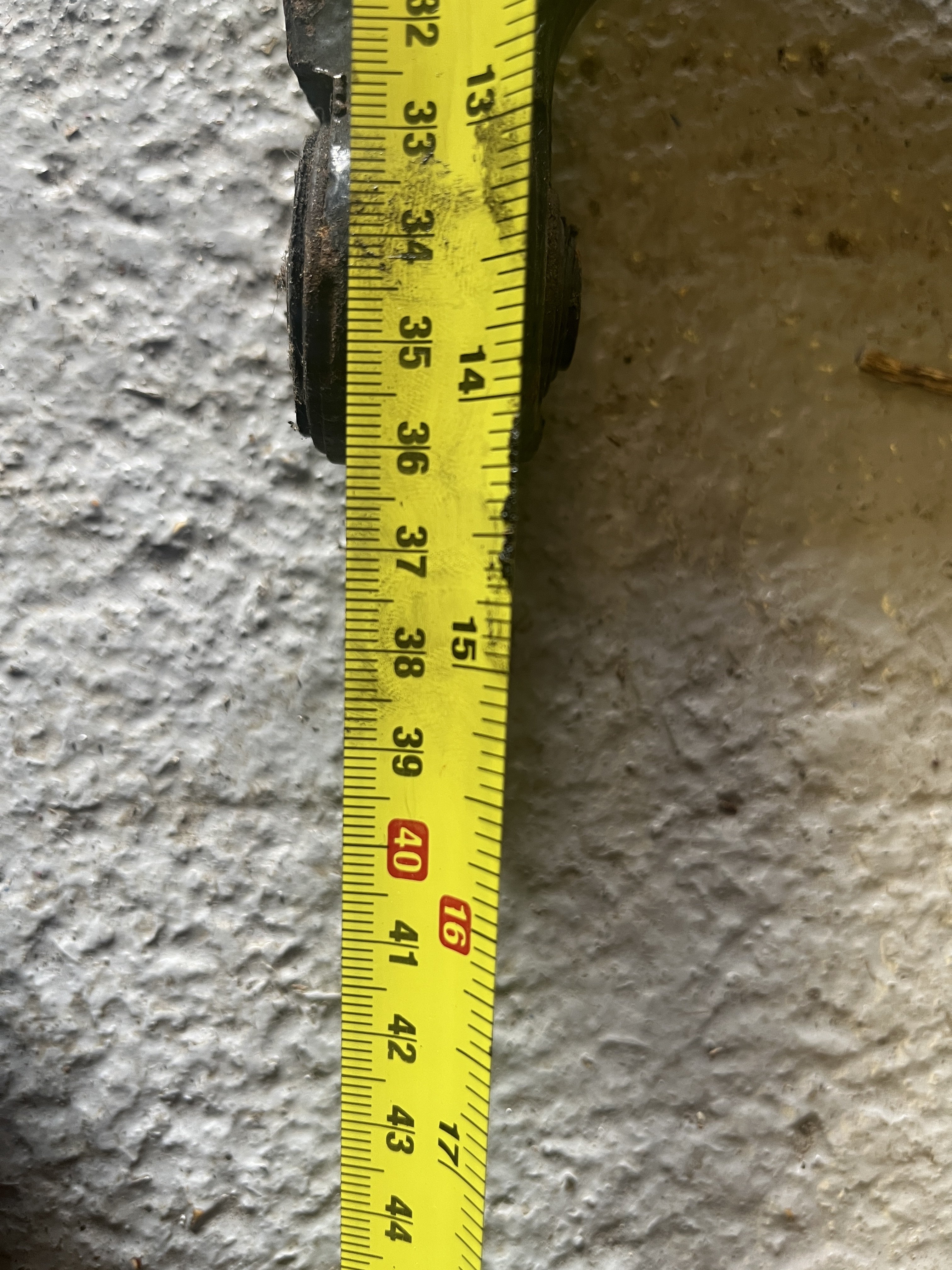

kyepan
If I have a set of 36cm wishbones, that have the casting with the two raised ribs, are they 205 or 309… I’m a bit confused, the ones on the car have no casting ribs the ones off the car do, both same length
