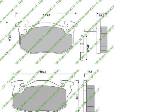

pugpete1108 62 1 Cars Posted March 5, 2009 i got a set of pads(only cheapies for now) from fleebay for the 205,they were listed to fit a 1.6gti and a 1.9gti? with bendix callipers. also i think they are supposed to fit base models. they look fine but seeing as i have long lost the old pads i cant compare or even remember the correct fitment of them. the pads fit fine and i have a fitting kit too (springs and shims etc.), the problem is they do not sit flush with the out edge of the calliper as ther is a little lug stopping them(circled in pic). have i got the wrong pads? calliper. pad Share this post Link to post Share on other sites

pugpete1108 62 1 Cars Posted March 5, 2009 (edited) They look fine to me, i've never noticed that lug, neither a cut-out in 1.6 pads! after going on brakeparts.co.uk it seems there are two types for the 1.6, a symetrical set (like mine) and a non-symetrical set which looks like it has a cut out for the lug. think ill just bodge these for now just to get it back together then get the correct set later on will this be safe? like this Edited March 5, 2009 by pugpete1108 Share this post Link to post Share on other sites

jplautomotive 0 Posted March 6, 2009 i had the same thing when i got my mintex pads when had stock 1.6 brakes bought the ones you show first , but needed the ones in the drawing jonny Share this post Link to post Share on other sites
pugpete1108 62 1 Cars Posted March 7, 2009 i did consider grinding the lugs off, then thought whats the point like you said for a few quid. just ordered a set of ofset ones (genuine bendix ones too) for like 12quid or something off fleebay. so if anyone wants a set of non ofset pads let me know. Share this post Link to post Share on other sites
