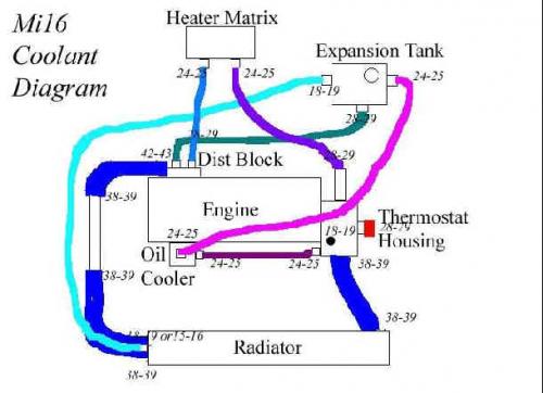

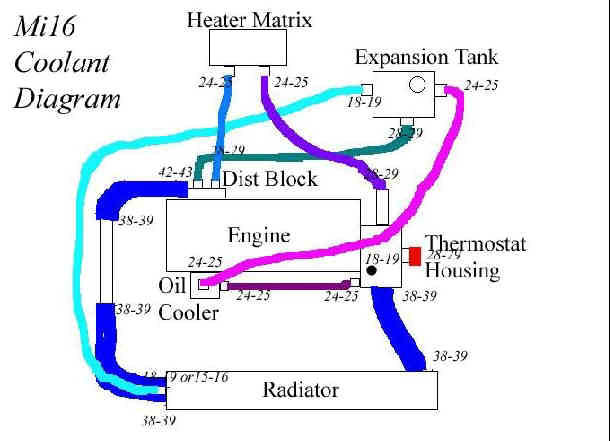

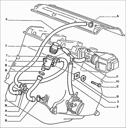

I have recently installed an 1.9 Mi16 into a 205. It is running but not very well - but think this is down to air leak on pipe between AFM and Throttle body.
What I am struggling with is all pipe work. I have found some drawings from previous post but I thnk that these are not the complet picture.
If anyone know where i can find more drawings or any technical manuals could they please point me at them?
I have attached the drawings i have been trying to work from.
a couple of things that I could really do with being clarified PLEASE
1 - on the Throttle body there are 3x outlets - 1 T's off to the oil filler neck, where do the other 2 come from/go to?
2 - Coolant hoses - I do not have coolant running to oil cooler therefore have header tank direct to Thermostat, Correct?

Cloverleaf
Re. the throttle body...
2 - goes to the oil filler neck
3/4 - they are to circulate the coolant through to heat the throttle body - i choose not to connect these
Coolant hose wise...I'm not entirely sure what you mean...maybe my pip will be some help

perfect, thanks Cloverleaf. That is exactly what i was looking for RE throttle body.
RE Coolant pipe - in my pic of coolant hoses it shows one coming from the header tank to the oil cooler then a return form oil cooler to thermoatat. But on my engine I have run it straight from the header tank to the thermostat. - don't see this an issue though.

Think the coolant routing should be OK as you've just missed out the cooler.
