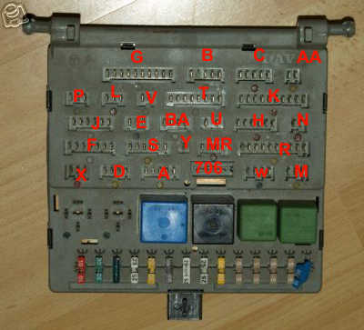

Yellow connector? Is the car an XU or TU? The XU colours afaik are grey, blue, green and white.
In any case, I can't remember which connector is which colour (can check in a couple hours), but the four connectors are 7-pin, 8-pin, 9-pin or 10-pin. According to the workshop manual, in the 9-pin connector:
in GTIs pre1986 - wire 14 on pin 4
GTIs 1986 on - wire 14 again on pin 4
GTI 1988 on - wire 25 on pin 3, while pin 4 is wired as M25 (a ground)
In the first two cases, the wire is coming from the dimmer switch..Leading to the dimmer switch is 14A coming from V on the fuseboard, pin 2.
In GTIs 1988 on, the wire is coming from the dimmer switch also, but leading to the dimmer switch appears
to be wire 25, coming from K on the fuseboard, pin 7 as wire 25A.
Hope that helps. That's all according to the manual, would need to check my spare looms, but it's the dead of the night here (4 am) and I'm not going in outside to the basement. :D

This is a G-reg 1.9 XU engine
I have removed the dimmer switch but kept the single green wire which comes up from the fuse board to this switch. (will have to check tonight which number it is)
Keep the info coming and I will have another go at it all tonight.
