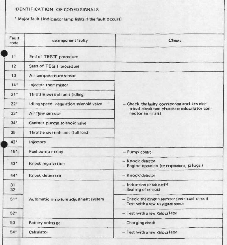

maybe somebody can give me these codes and meanings - I really need it and I don't find this anywhere.

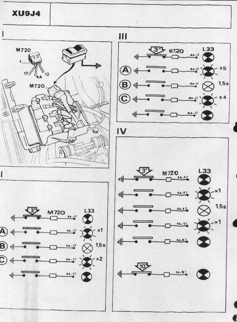

you car is cat(dkz) engine? .... if it is posible failure is.. lambda sensor,ecu temp sensor,afm....
you first find diagnose connector somevherein engine bay( mine is near expansion botle and simpli plug switch betven earth and pin 2(diagnose con) and count blink( on K-light) (look diagram)

that's right socket conect svitch betven pin2(see picture of socket)and ground turn ignition key to position 2 and press svitch, k light blink code 12( start test) -now you must read carefuly manual... if test mode dont start you have problem( dirly contact in socket, viring to ecu...)
