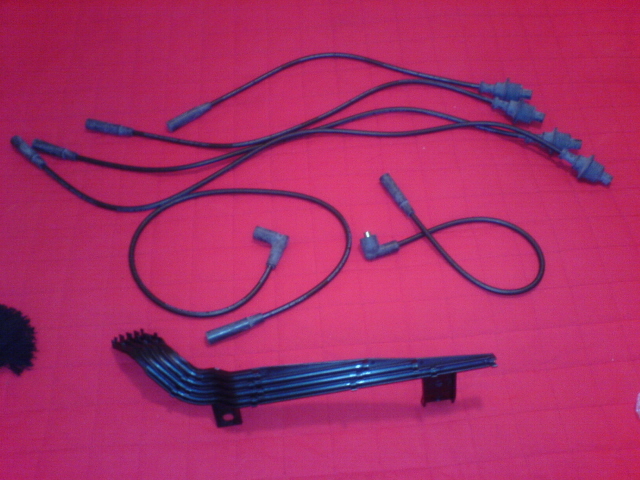

Hi,
I bought a new HT leads set. Inside there was 6 cables. I dont know what 2 of them in the center does? Can you help me to change the leads?
How can I remove the leads from the dist side?.
I also bought lead holder. It was missing, the old owner did lots of weight loss :ph34r:
where should I bolt the holder on the engine ?
those two shorter HT-leads are for connecting the coil to the distributor cap.
you only need one, but i guess they've included two of the different lengths
due to different position the coils can have (on inlet manifold or inner arch).
the holder bolts onto the cam cover, you can just about make it here:
http://www.205gtidrivers.com/info/enginelayout.html
hope this helps.

OK I will look to coil and check the lenght. But also how should ı remove the leads from dist and coil, just pulling ?? :)
toddydal
yeh they just pull off but do 1 at a time so you put them back in the right order
