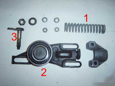

Ok, so I've got the old spring loaded tensioner.
Am I right in thinking (i've never done a Cambelt before) that the tensioner is undone, it springs to the belt tightening it up, I then tighten the bolt up again and to check tension I should be able to twist it slightly?

Ok, so I've got the old spring loaded tensioner. Am I right in thinking (i've never done a Cambelt before) that the tensioner is undone, it springs to the belt tightening it up.
With the cambelt tensioned the spring(1) pushes the roller(2) against the belt pulling it tight.
To remove the tension from the belt so you can change it there are two 11mm nuts to undo & the cam (3) needs turning through 90" after you have undone the 16mm locking nut underneath the exhaust manifold to pull the tab against the spring & release the tension from the belt.
Yes, no more than 90' but ideally less imo.
