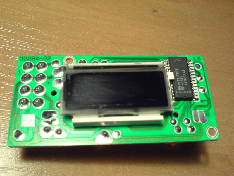

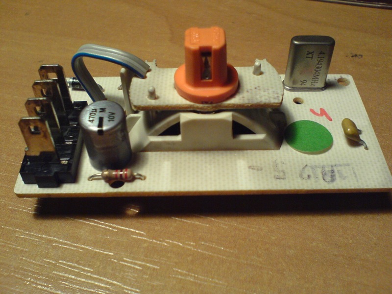

Para 82 2 Cars Posted February 12, 2009 Maybe this will be helpfull Share this post Link to post Share on other sites
