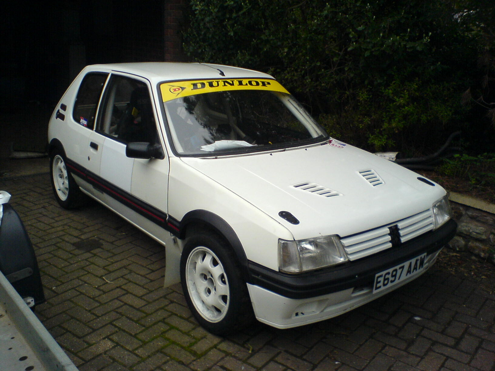

bensonmi
id say black on a white 205,but white also suits the rally look!

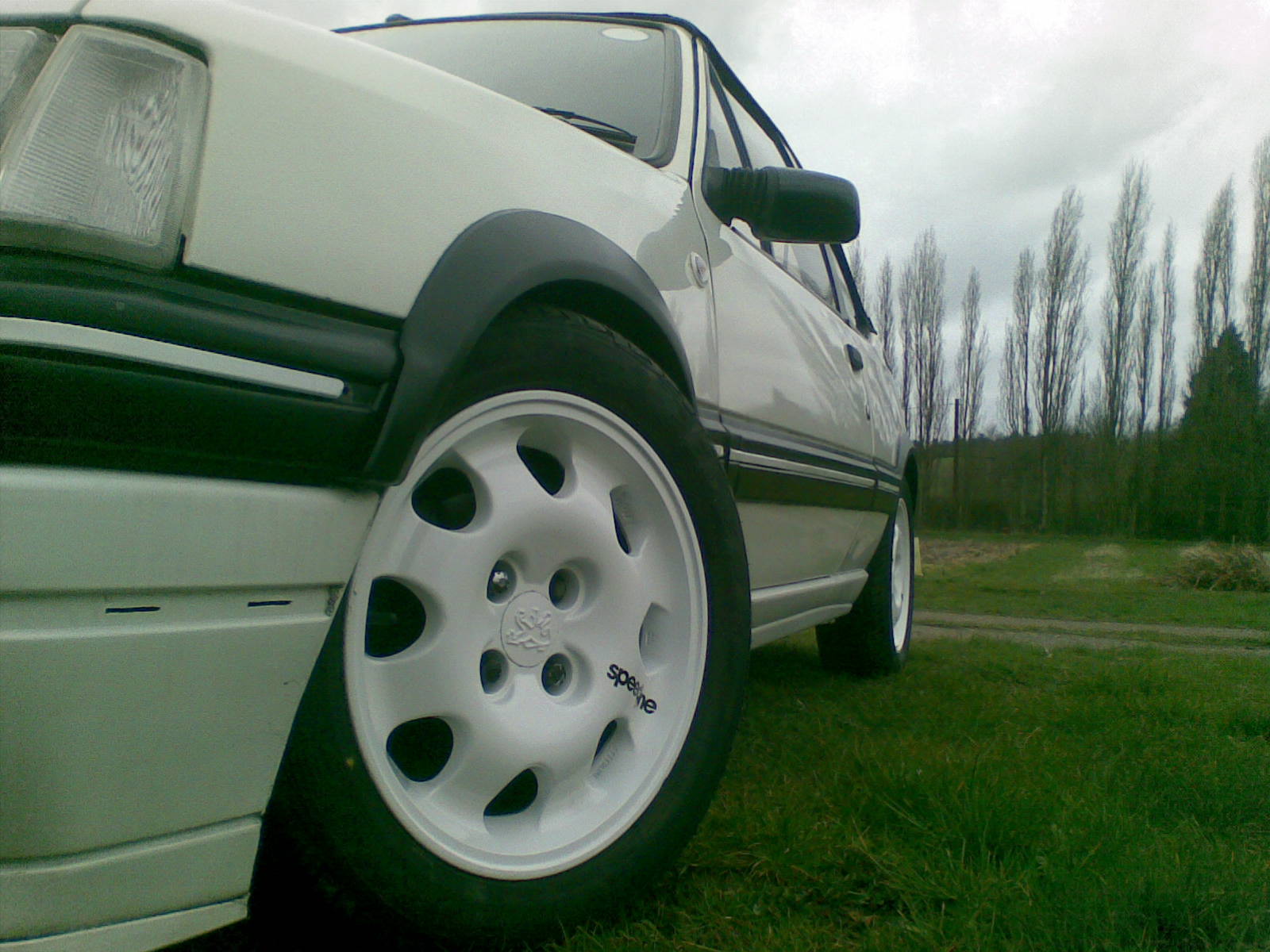

gti-hysteria
i like white :blush:

Chris H
I'd vote for white too...just did my wheels with cheap halfords wheel spray paint.
