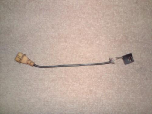

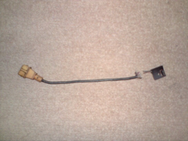

Basically I want to know what the purpose of this wire is and if i needed it? Im using a bosch 8v 1.9 distributor.
Its a 3 pin yellow socket, which attaches to the loom and has 3 wires red, black and copper wire which connects to a 2 pin plug which is screwed on to the dizzy.
Sorry photo not very clear. As you can see the wire is broken.
Edited by cherry_red
Yes you do need it, it sends info to the ECU for fuelling!
CosKev
If your running standard ECU/injectors etc your car won't run without that connected.
It transfers the signal from the dizzy to the ECU to tell the ECU the engine is turning over ;)
Like a crank sensor on modern cars :)
About £38 from Pug if you need new one :ph34r:

Ok, then is it possible to get a new one? Im unsure of the name for it, as it just says wiring plug in the haynes manual.
I could just crimp it together, but ideally I would like a new one.

Well I'm running carbs so the fuel injection side of things isn't being used. Will I need it for ignition timing?
No, you can live without it if using carbs.
