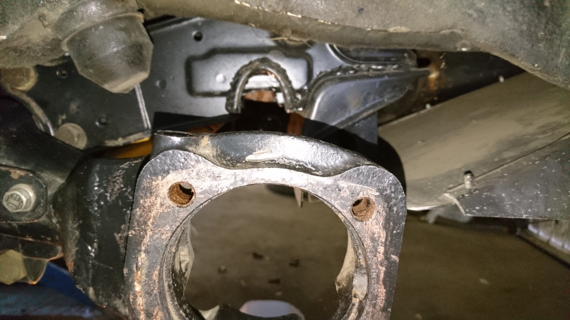

I bought them used from spoox directly - and upon further investigation, they are actually already fairly bend, even the advert said ' mint condition ' and from undamaged car.......and they where not exactly for free.
Will call them up and ask if this is their usual service quality level?
there is a bend in the design as the outer insert is welded in straight.
lybker
Please explain, I no not exactly follow?
What is the preferred fix ? I thought of welding in a vertical reinforcement full length from front joint to outer joint...
if you do plan to use those compbrake wishbones I would weld on some ribs to stiffen them up, I've heard of a few failures under heavy braking where they have bent, an Aussie member posted a picture of his a few years back.
It was my friend Parry. They fold up easily in that condition. I think they now have 40x10 ms flat bar, welded on edge, in order to stiffen them up.

Sorry, I was wrong. Parry has seen this and sent me a photo to post.

Thanks for the support, I have already sheets cut to size for reinforcing the arms, so with a bit of luck, i will find time during the weekend, as I also need to extend them 50mm to accomedate the wider track.

Wishbones are under modification and are 50% done - so som work in progress pictures showing:
  • Getting straigthened - taking out the damaged they had upon reviecing them
  • Extended 50mm - to accomedate the wider track
  • Reinforced - to both protect the extension and to prevent further bending during usage
just missing a bit of paint,and they will look like new :-)

The wishones are done, lets hope they are though enough to handle any kind of punishment - next step is the fiddle to remove bump steer :-)

I hope you trust your welds! those extensions look - special!
lybker
haha you might be right, my luck, good looks aint everything then :-)
they are chamfered with full burn in and the insert has a large square area than the base material, similar to how I extended my old wishbones with similar comments. They are holding up nicely and are even cast iron, preheated to 150C prior to welding.
