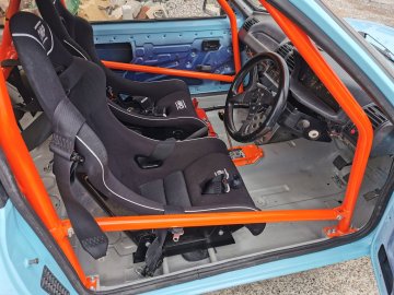

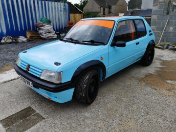

  • Short Description Originally 1.6gti, now GTI6. Fully stripped and caged
  • Car Type / Usage Trackday car

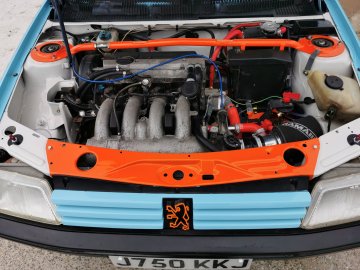

  • Engine & Gearbox GTI6 Stock engine, Fully rebuilt head with all new guides, 3 angle valve cuts etc etc. 1.6GTI box with longer 5th and 3J plated diff.
  • Suspension & Steering Bilstein Challenger dampers, Eibach 7001-120 springs. PTS 22mm Torsion bars and PTS 25mm rear ARB. Front ARB Standard. BakerBM solid rear mounts and Group N front. Corsa C EPAS
  • Brakes 307HDI 266mm front with modified Clio 182 DS1.11 pads, Standard 1.9 rear.
  • Wheels & Tyres C5 'Steelies' with NS2R (Dry) or Toyo T1R (Wet)
  • Bodywork & Exterior GTI trim removed, MaxiMotorsport Narrow arches. Resprayed 1978 Daihatsu light blue
  • Interior & ICE Fully stripped with OMP Champ R seats, Turn One FIA 6 point belts and modified OMP Cage. Interior painted satin off white.
