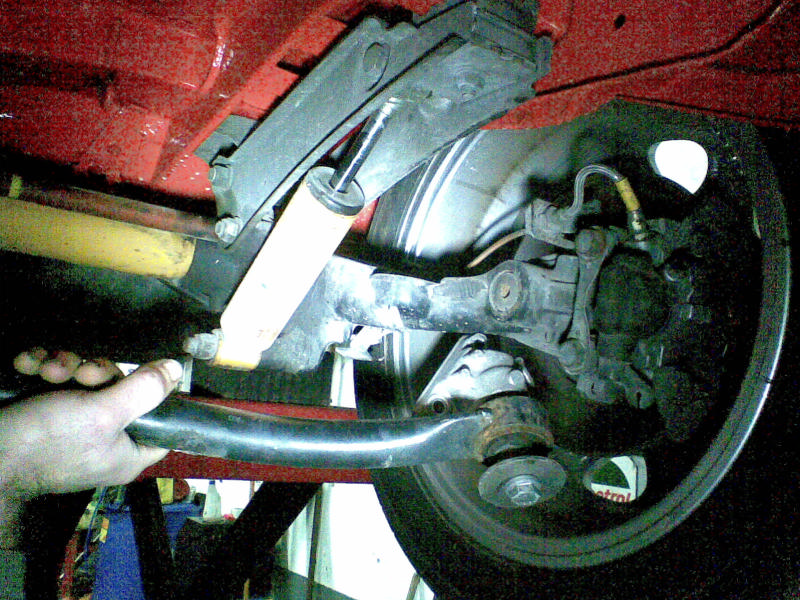

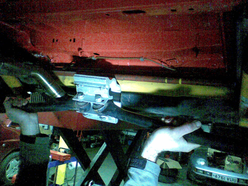

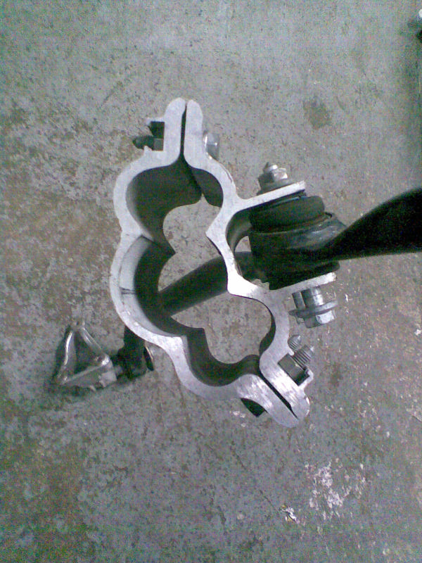

Here we go...
rex
Trailing am off a 206 SW with drum brakes - the stubs knock out to ad the hubs for the discs, but the caliper monting plate will need to come from a GTi 180 or a 206 HDi with rear discs...

I think the other problem you've missed is that the 206's torsion bars are above and below the crossmember tube, on the 205, 309 306 zx and xsara, they are fore and aft, so the bracket shown above wont fit.

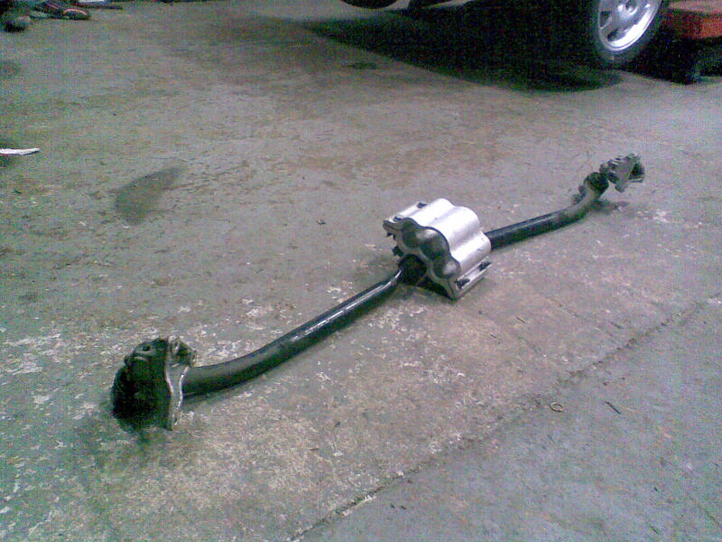

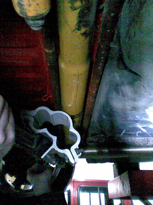

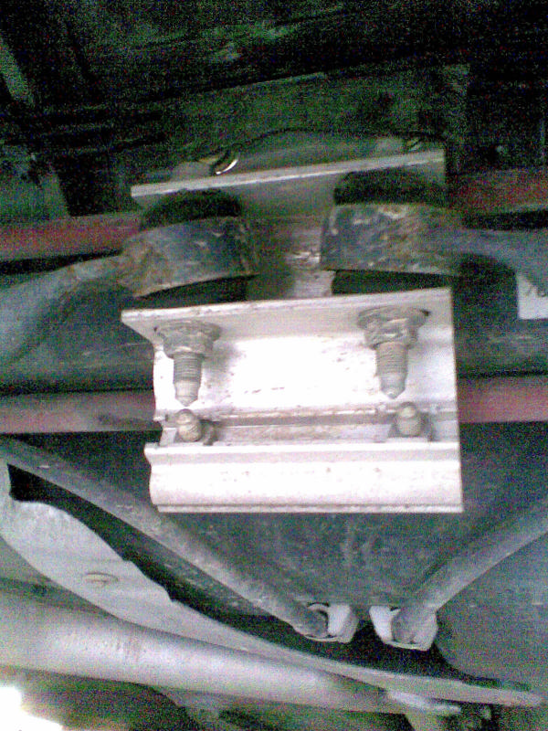

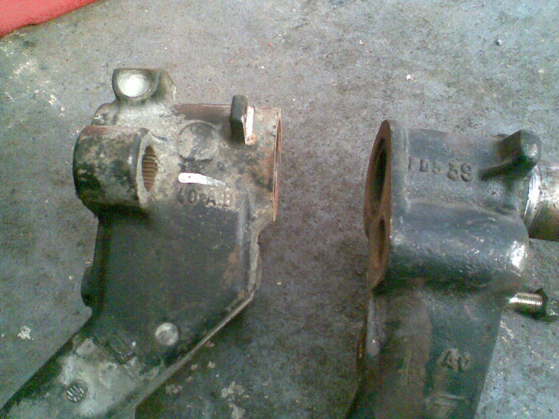

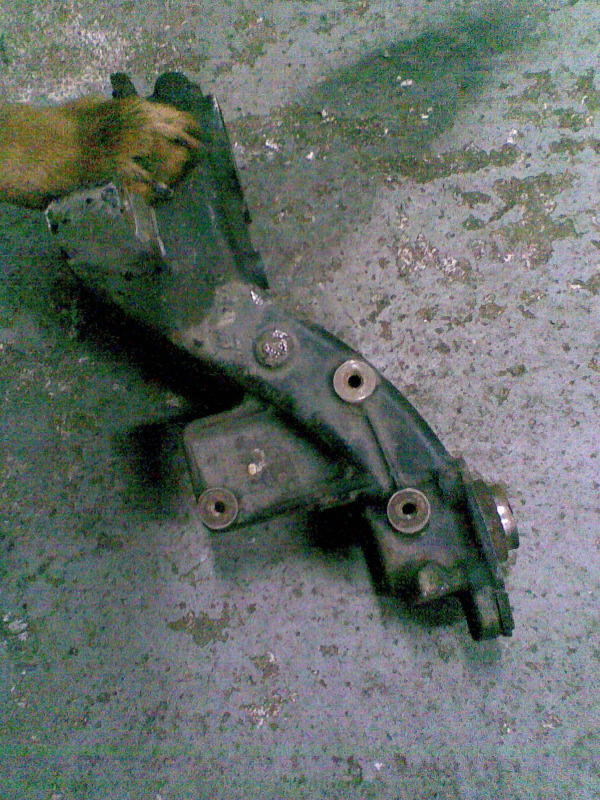

More....
And more...
And even more...

You got me worried for a minute Welshpug, but I'm using the 206 arms - as you can see from this photo, the bracket will fit, only my torsion bars will be over and under like on the 206. That said, I'm now left wondering if they'll clear the fuel tank in the new position.... :)
Top photo is the subframe as it was on the 206 SW. Below left is the 206 arm and right is the GTi arm. If the space between the central beam and the tank is ample, we're laughing.

How is that going to work, as that's going to involve twisting the torsion bar massively to get that to work at a sensible ride height, particularly if you're running stiffer torsion bars? You might be using 206 arms to move the torsion bar mounting point at the arm end, but the beam end will still be in the horizontal position thus requiring a 90 degree odd twist in the torsion bar.
You'd be much better off redesigning the beamtube bracket to allow it to be mounted horizontally and retaining 205/309/306 arms in my opinion.
